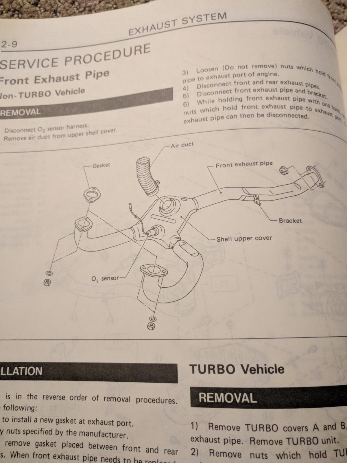

Alright guys, parts are here, but I've got a maybe stupid question. See the metal post coming out the middle of the CAT in the Y pipe section? My current Y pipe and Catalytic converter doesn't have that. The FSM says there should be an "Air duct" there, what is that supposed to connect to on the other end?? The plan is to buy a pair of nuts and bolts to connect the midpipe to the muffler, and then try to replace this thing tomorrow. If I can't figure out what to do with the air duct, do you think I could just cover it and be ok? Thoughts? -

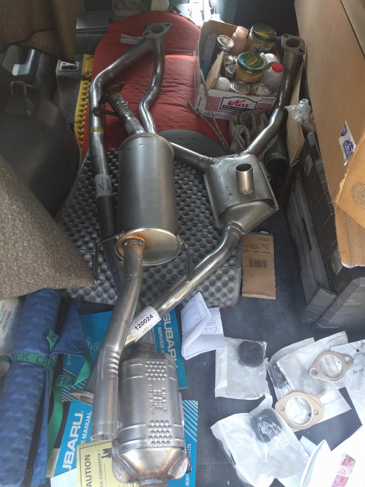

Well I just ordered everything gaskets and all to just put on a whole new exhaust pipe from front to back. $450 USD including shipping to Canada. Here's hoping the 1990 Loyale mid section fits! -

Yup I read you loud and clear there Jono, I'm putting together an order on Rockauto with all the parts to just redo the whole exhaust with OE shaped pipes (and the mid pipe/cat from a 1990 Loyale) then gonna compare that to what a shop would charge for a custom setup here and go with the better option. I like the idea of a whole new setup because then no detritus from a broken catalytic converter or anything else could possibly be in there. -

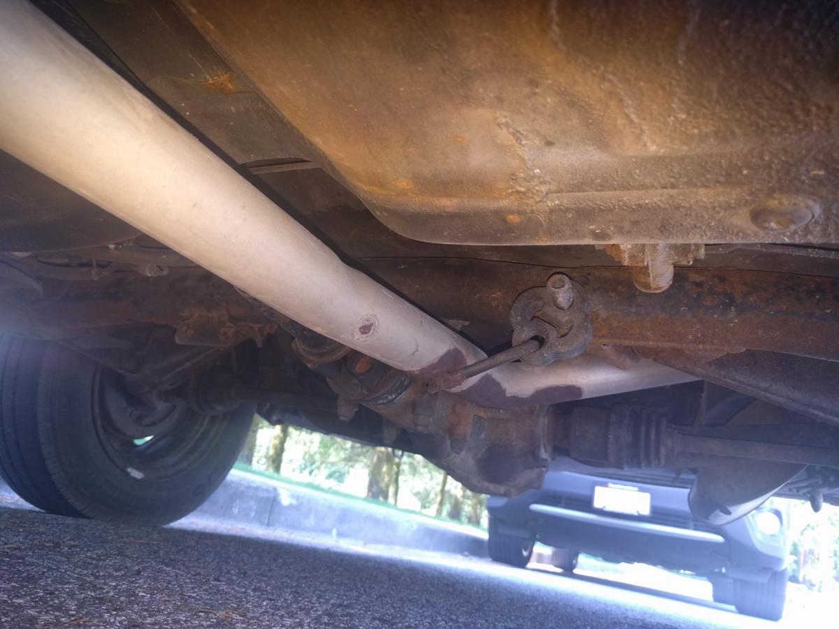

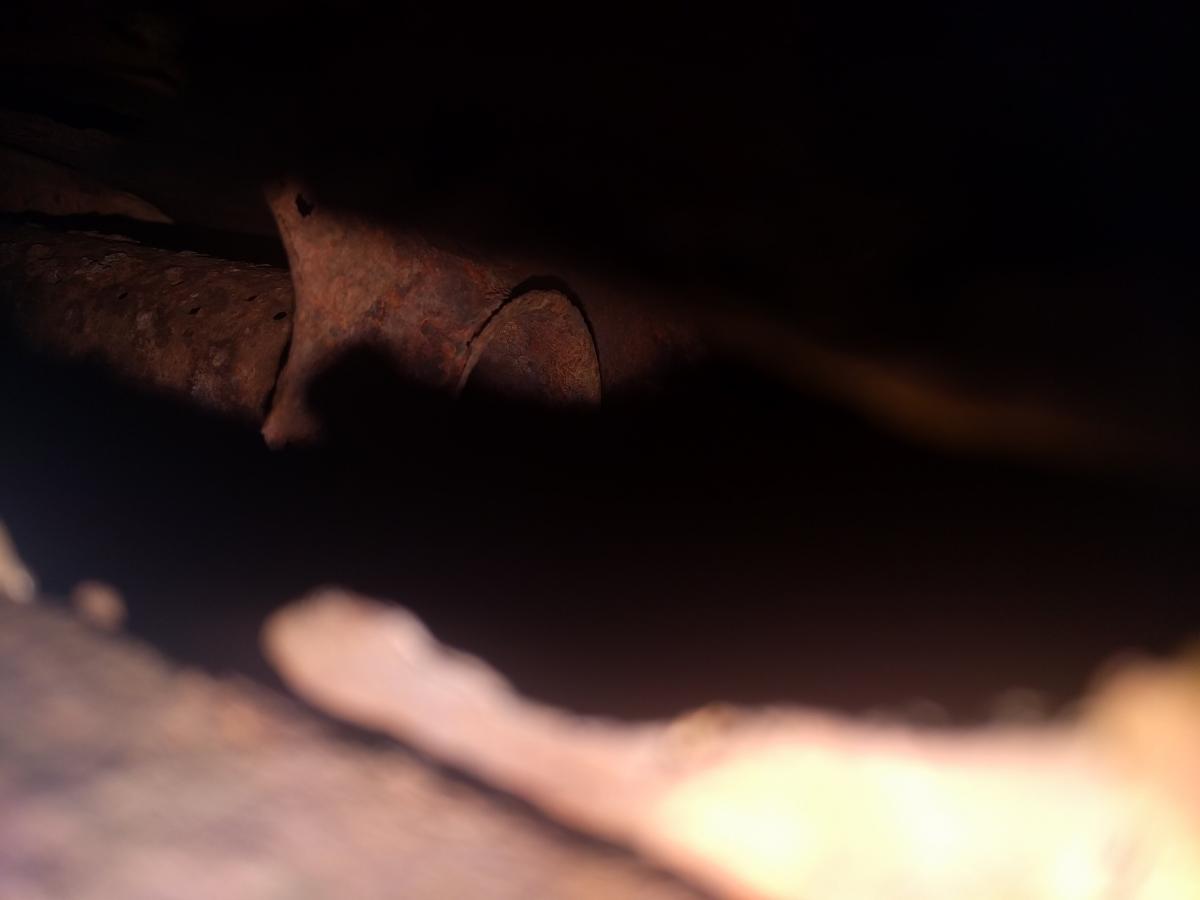

Here's a few more photos from the rear exhaust pipe back to the muffler, I guess whoever replaced it last just welded them together because there's no gasket or bolts, just a welded pipe. Chatting with the folks at the Subaru Dealership it looks like I'll probably have a hard time finding parts for this one. If I can I think I'll just do the whole exhaust just to have it done in case the front Cat goes bad someday (I mean heck it might be already) -

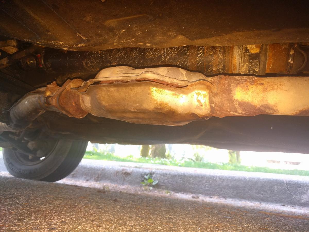

Well you guys were right about the bolts being rusty. I almost got the self locking nuts to break but the they just stripped. I could probably rent an angle grinder and cut them though. Looking at the catalytic converters they both have little metal flakes coming out the holes in the bottom, and they both say Subaru on them so they're probably the originals and if not broken, very tired at least. The muffler looks to have been replaced before and I guess they must have just welded it straight to the rear exhaust pipe rather than bolting it with a gasket because from the connection just before the second catalytic converter all the way to the tail pipe it's just one piece, not two like the FSM says it should be. So now the real question is if I can even get parts.. the hunt begins! I think if I can find all the pieces I'll probably just take it all off and replace it all at once rather than renting an angle grinder and chopping the bolts to just do the rear and the muffler. This should be interesting and fun! hope I don't go too broke. Here's looking at the muffler from below, then trying to take a peek inside. it's obviously not functioning even close to as it should be now. -

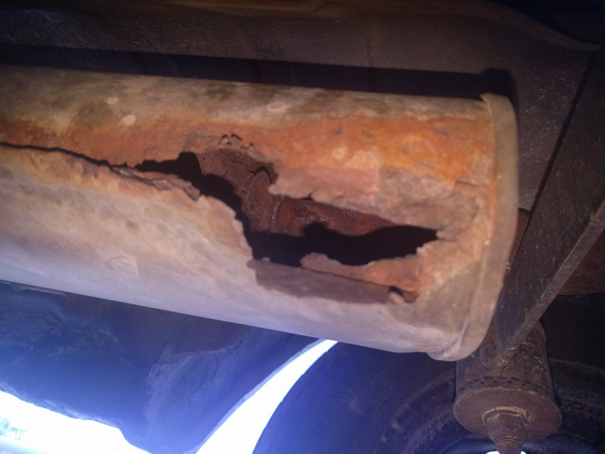

Hi Guys, I'm currently in Vancouver BC, Canada. On a migratory road trip from Utah to Alaska in my trusty 87 GL Wagon. Before I took off I worked on and fixed everything I could think of to try and make it a solid and dependable ride for the trip, I noticed I had a rusted out hole in the seam of my muffler, but it didn't seem to be effecting performance and basically just made the car sound like it had a glass pack muffler on it so I let it slide. I've never done any exhaust work before aside from replacing manifolds, and accidentally pulling one of my studs out of the cylinder head when I re-sealed the engine (Still gotta helicoil that or something) Then on my way through Grand Forks, British Columbia, they just so happened to be in the middle of a 200 year flood, but the road was still open, so I drove through ~2-3 feet of water on their main drag downtown. (Here's a video I shot if you're interested to see what that looked like) When I arrived in Vancouver, and was idling at the stoplights on my way to a friend's place, the exhaust started rattling so loudly that I thought it had come loose and was somehow smacking the body of the car. That rattle comes and goes now, only when I'm idling. The engine idles at about 1000rpm when it's warm now instead of 700 like it used to, I've got a sort of noticeable power loss, and my gas mileage has dropped 4-6MPG. I'm pretty well assuming the muffler needs to be replaced, it sounds like there's something loose in there that knocks loudly at idle and is partially blocking airflow. So here's what I'm wondering as I'm thinking about getting this fixed and moving on towards Alaska: -It looks like the exhaust essentially has a front and a rear section, so provided I can get a new rear section here, is this something I would be able to do in someone's driveway (assuming someone will loan me their driveway) with a pretty basic socket and wrench toolbox? That's what I've got. -Anything weird I should keep an eye out for while looking for parts?(gaskets, springs?, bolts, Junkyards maybe?) I've never bought parts in Canada before. -If I do too much running around with my exhaust a little messed up like this is there some potential engine damage in my future? I imagine this can't be too good for it. -In the meantime would I be better off just cutting off the muffler and running a straight pipe? Since I'll be replacing it anyway? It's late so I'll probably post some photos tomorrow, any thoughts or advice would be much appreciated. Thanks a million, as always guys

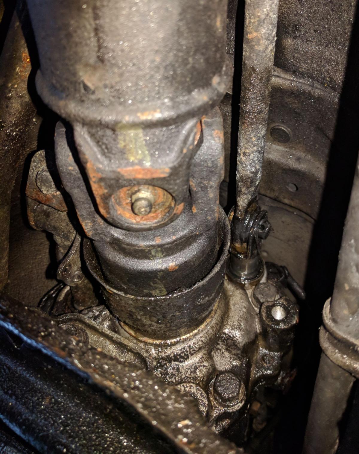

Ok so I finally got the opportunity to really take a good look at things down under and I believe what I have going on is a combination of some exhaust shield rattle(is that common on these?) And a uni joint that's right on the edge of going out, it has the tiniest bit of play in it, is pretty rusted all around, and has been replaced before, as evidenced by the grease port and the snap rings. First I'm going to try just greasing it to see how that serves, and if things don't get significantly better I'll just pull the prop shaft and replace the joint since I found one on Rockauto for $4 anyway; should be easier to do since the original stakes have already been milled out!
