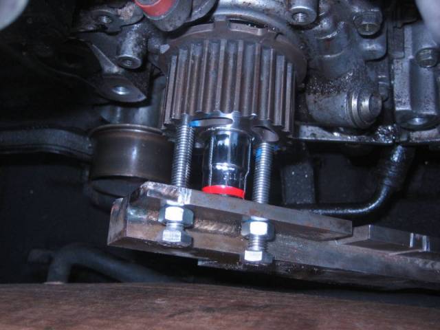

99 PhaseII SOHC. If your crank gear is stuck on. Here's a pic of my crank gear sprocket puller setup, using the M8x1.25 tap-existing-holes method. (There are two round holes through the stock gear, on opposite sides of the crank. They are the perfect size to thread with an M8x1.25 tap) This is not my idea, but it is my pic. In this pic: the gear is already partly pulled off. A socket has been inserted at the end of the crank to continue. I used nuts to allow the bolt to remain fixed in the full thread of the hole, since the tap did not go exactly straight and I only got about 7-8 full threads on it. It slid off pretty smoothly, at first one flat at a time, then later more easily. Notice the broken tang from a previous attempt with a normal puller. Also, since eveything around it is aluminum, do not try to pry a reluctant gear off the crank, you will just do more damage. This is the $10 solution.
Crank gear sprocket presses on radius?
Is the crank gear held fast in place by being pressed tight against the small radius at the base of the crank nose? I have a cracked woodruff, and looking at the small size of the key, it seems unlikely that it would bear the full brunt of the cam drive. I can understand why they would not use a full 'morse' type taper, because those can unfreezably freeze. So the crank bolt presses BOTH pulley and crank together and agains the radius taper? Here's a pic of my crank gear sprocket puller setup, using the M8x1.25 tap-existing-holes method. Worked just fine. Thanks to the author of that idea. The gear is already partly pulled off. I used nuts to allow the bolt to remain fixed in the full thread of the hole, since the tap did not go exactly strasight and I only got about 7-8 full threads on it. It slid off pretty smoothly, at first one flat at a time. Notice the busted off tang on the gear. I ground down the tips of a regular puller to fit, but that was the result. NEWBIES NOTE: read up on tapping a thread before you start. I nearly snapped the tap off. Tapping must be done in stages, backed up each 1/4 turn or less to snap the preceding chip off. Use oil, get it as straight as possible, and remove it entirely afer each two full turns once you are into the full threads.
