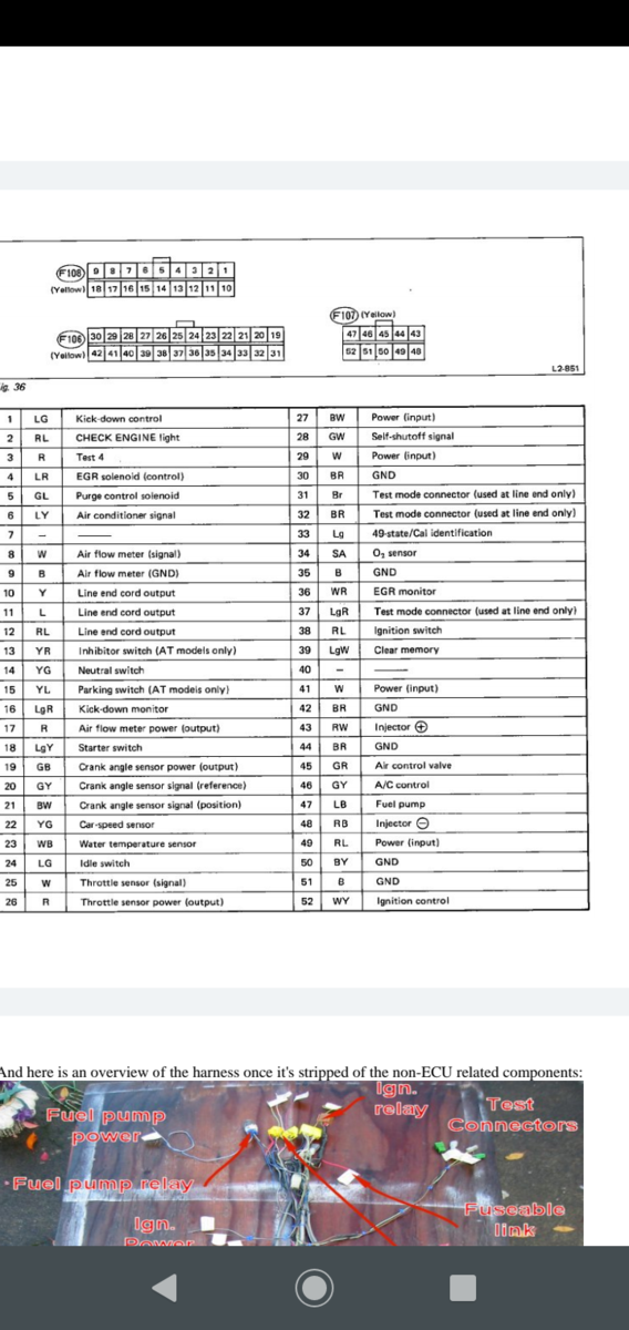

  2. I have an 82 brat I am swapping to Fuel injection using @GeneralDisorder guide. I have everything in place and wired up. My issues are as follows. I am only getting 6 volts at the coil. And I'm not getting any spark. My fuel pump works. But only shoots fuel when it is hard wired. It won't turn on in test mode. Nor when I crank it I don't think. The ecu blinks at me when my key is in on which is a good thing I think And the engine turns over. I have looked and read, then looked and read, then looked and read again through the guide and my harness and I really believe I have everything hooked up correctly. Minus the neutral switch and cel wire. Any any any help would be Uber appreciated!!!

  6. Thanks gd any chance you have a ecu pinout diagram for a 93 loyale. I'm using your spfi write up. But the 93 pinouts don't match up to your diagram. The parts car was a 93 loyale auto.

  10. I'm not seeing the pin out for auto/manual .
