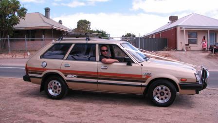

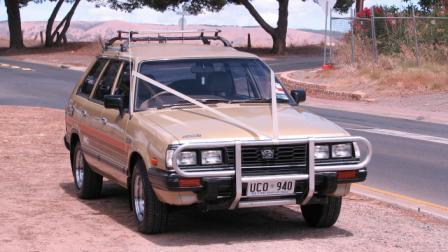

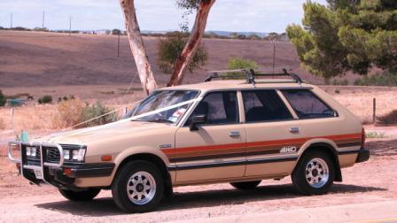

  10. Hey all Well I got a strange request a few months ago from a couple that approached me at a supermarketto use the soob in their wedding, it suited the 'surfie' theme they wanted. The big day arrived and the soob looked smick had to share some photos. Ones even got the owner in it:banana:
