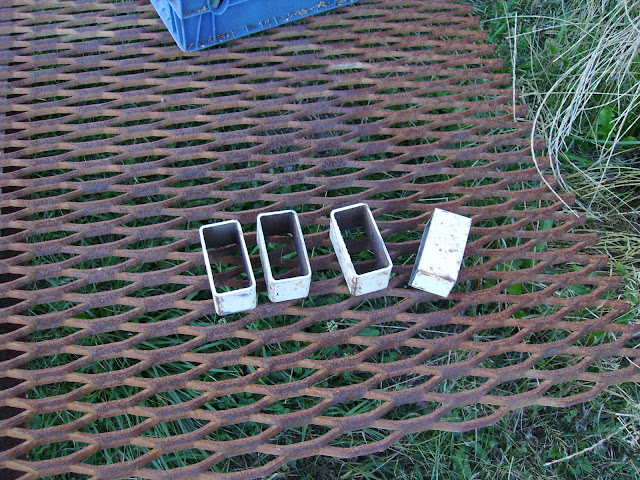

    My lift has 1/8" wall 2"x4" blocks. I beat it until the steering linkage gave up. Yes, the steering linkage. No bent or broken blocks. If linked properly, you just don't need 1/4" material. Would

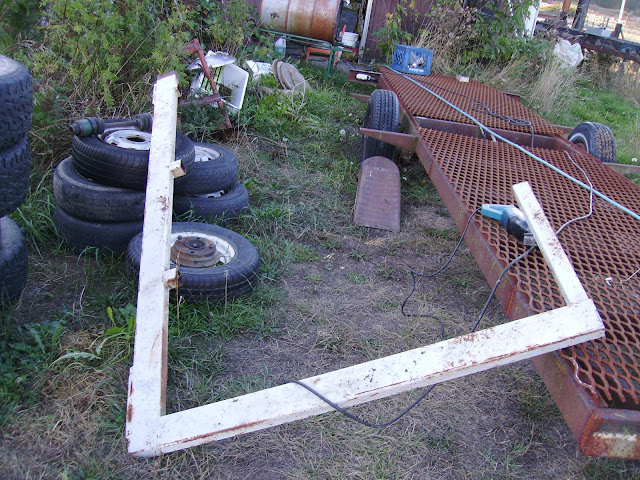

This is what i have to work with:
and i have a LOT of it.
And what i have done so far:

I now have 14 2x2x4 blocks that are ready to be drilled.
i got the 14 from a site where a guy put a 6 inch lift on a brat. not sure if the number is the same for gen 3's

I can tell you right now those blocks are too thin unless you sleeve the bolts or reinforce them from the open sides. Anything thinner than 1/4" wall thickness will be smashed (the sides will bow outward or the whole block will start collapsing to the side). I've seen this first hand with a 4" lift on an EA81 - 3/16" wall thickness was used and the blocks collapsed and the bolts came loose. It will be ok if you aren't doing any of the rough stuff at all - just driving around town on the street is ok. But when you need to get some suspension action going..... bad juju my friend.

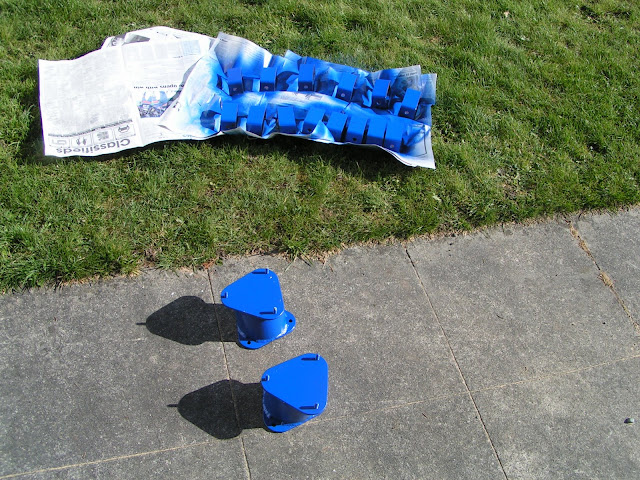

More progress today! I have the front end all done except for a tie rod and the motor. Then i have to wait for paint to dry and i can install the driveline and rear diff after i do the shifter linkages :banana:
