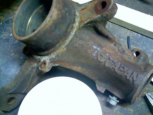

Ok, got some pics.
This is what it looks before it goes in the soup.

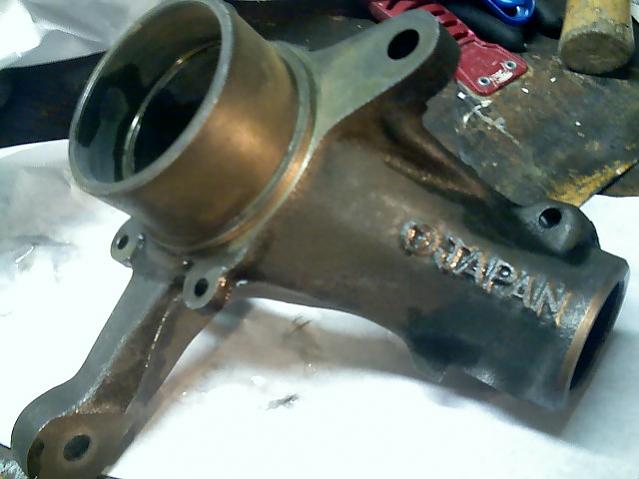

Six hours in the soup. Still has minor surface rust but when I spray it with brake cleaner before I paint it it should be good to go. I might even put it back in for a couple more hours.
Next to a subaru knuckle so i can compare what was to what will be. :)

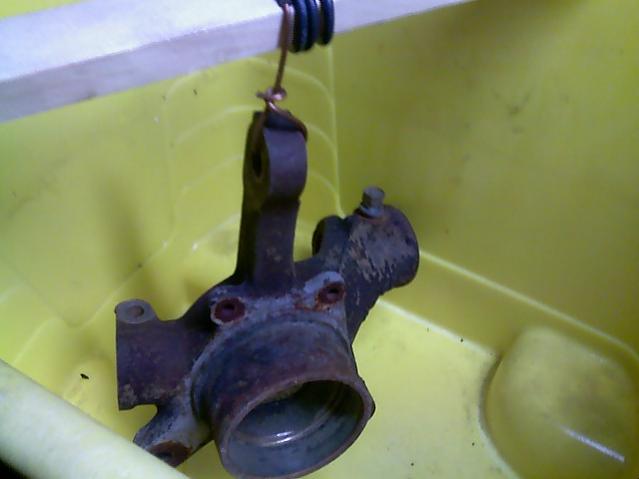

I just got my Subaru knuckles back from the hot tank. I have the rusty parts wired for tomorrow. I'm baking soda at 300 Fahrenheit for an hour to convert it as per the directions on that website. Tomorrow I'll mix the solution and put a battery charger to it and put up some before and after photos. This is waaay cool.
Edited by Txakura
300F is not swearing
Left everything boiling like mad, hoping the shop is still there tomorrow :-\
I realized today an old cooler would make a nice tub for this, built in drain to rinse it out and all plastic... handles for moving and a lid for storage.
wanna hear something funny? some guy's web site had his before and after... he couldn't figure out why his part was rustier than before he dipped it
if you read his text, he connected the positive to the part to be cleaned - he doubled his crud :lol:

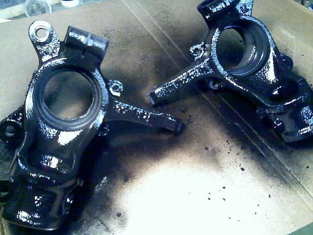

Thank you WRX2FFU for posting this, this is the coolest shop trick. I got amazing results and this is a great tool to have in the inventory of old school tricks.
how long did you leave it in there for?
Looks great
BW
overnight, I could have cut it short and used a conversion coating once the majority was off but wanted to see how far it would go
