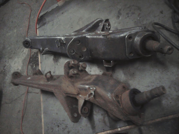

I am rebuilding the back end of my 86-3door while converting 2wd to 4wd with xt6 5 lug. I am wire wheeling the suspension tube, trailing arms, and backing plates, to por-15 them, and seam weld some of it, and try to fashion end caps on the tube frame to keep the inside from rusting out.

I am also seam welding the tube frame where the mounts are tacked on. There are full seam welds from the factory, but there are other edges that are just overlapped with no weld, that crust can get inside between the layers. I would like to fashion some end caps to keep the insides from rusting out, as it is quite flaky I had the idea of welding them up and filling the inside with enough oil to soak into the rusty flakes and stop oxidization. Same with the trailing arms, since there is rusty flakes shaking around in them, and there are open spots in the stampings on the ends. I have seen these rust out at the seams and split in half.
