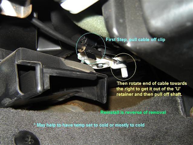

theres a clip on the heater box carefully remove the cable from the clip then turn it till you can slip the cable loop off the post on the flapper (on a '98 Legacy that is, dunno what youve got)

I believe there is simply a clip to release the cable.

For me with my big hands, it was easier, believe it or not, to remove the cable from the heater box at the passenger left foot.

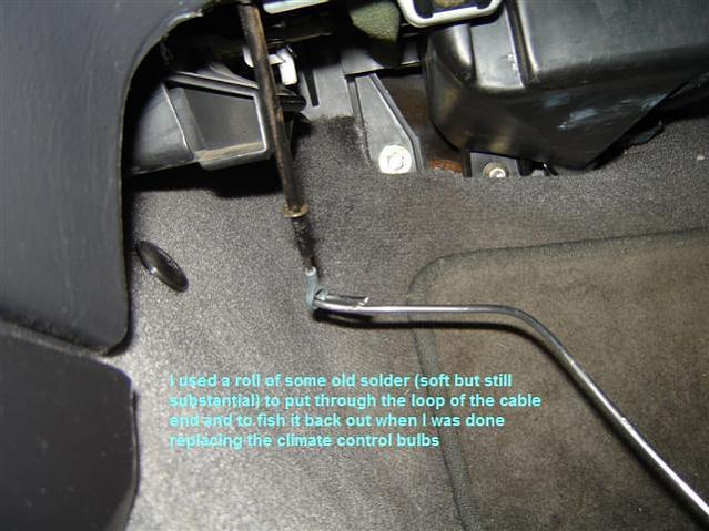

I've attached a few pics with some instructions on how I did it if it will help someone.

Excellent idea with the roll of solder.
I've done several of these and never bothered with string, wire or anything. Not to hard to fish that cable back down there.
Excellent job with the pics for the next person.
