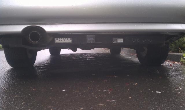

RAugur33 Posted May 8, 2011 Share Posted May 8, 2011 Here is the hitch I have for my 99 Legacy GT Sedan. Too wet for undercar shot. Hope this helps. Quote Link to comment Share on other sites More sharing options...
