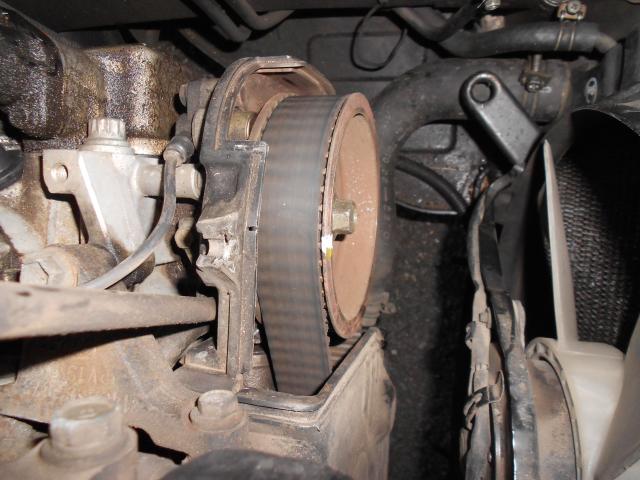

timfreddo Posted August 25, 2011 Author Share Posted August 25, 2011 yeah now there is 154,000kms. so only 32,000kms since timing belt, and i'm assuming idler pulleys/tensioners were replaced/checked. still pretty good for a 92. Thaught it was a bargain at the time.. Can you tell me if there is a mark on the metal of the cam pulley wheels? looks like the last person to change the timing belt went abit overboard on the whiteout marker. (hopefully the photo works...) The two whiteout blots did seem to be a little off, but it would be good to know if i can scrape the whiteout off without loosing the mark on the metal to investigate more accurately. Head gasket.. Mech just said they were blown, and gave me a huge bill if i wanted it fixed. there is no oil in coolant, or vise versa. there is a tiny oil leak from im assuming (from what i can see from under the car) the rear of each head gasket, but i'm not chewing through oil by any means... If the head gasket was that bad, it would affect compression test results, wouldnt it..??? Have yet to do wet comp test, how much oil and what procedure would you recommend? Another forum mentioned this might be the problem... http://www.ausubaru.com/forum/showthread.php?t=19809 I'm not an electrical guy, so this flys way over my head. help appreciated with the too if possible? Once again, thankyou for your advice and help. It's much appreciated by all who use this forum. Cheers, Tim... Quote Link to comment Share on other sites More sharing options...

nipper Posted August 25, 2011 Share Posted August 25, 2011 Get a used knock sensor and i am doubting a blown HG, totally doubting it. Start with the knock sensor. Comp test: Remove the fuel pump fuse and let the car run till it stalls. All plugs removed Fully charged battery Wide open throttle plate Crank each cylinder for or five times Record reading do four times. Wet with an old pump type oil can (improvise) put some oil in a cylinder. Repeat above. The oil will spread out but if you can find an aerosol oil that would be better. Record numbers If the numbers are higher you have tired rings, if not, it is the vlaves. If the numbers are within 10% of each other it is not the HG, especially on both of them. He may have meant tired valves, Quote Link to comment Share on other sites More sharing options...
