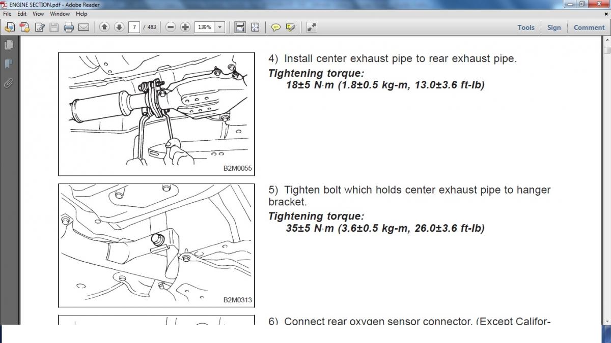

I plan to remove the 2 bolts (each with a spring around them) to separate the rear cat and the rear exhaust pipe. I'd like to clean out the surface rust on the flanges and put some rust converter on the flanges so they'll last longer. Both flanges are still solid with only surface rust. I cleaned out as much rust as I can without removing the bolts. But would like to do more de-rusting by removing the bolts before putting on the rust converter. Question is: do I need a special tool to compress these 2 springs when I reinstall these 2 bolts? It seems that, without compressing the springs, the bolts might not be long enough to reach the nuts. Also, anyone knows what material is this donut gasket made of? I'll be using a new one. 96 Outback.

that nut/bolt is way overtigthened, they aren't normally that compressed.
nice job posting a pic, that's always helpful and would have never been able to cover that with just words.
that nut and bolt looks decent, not too rusty.  hose it down really good with penetrant (liquick wrench, PB Blaster, Yield, Kroil) 2 or 3 times the week prior to getting into it and you'll be able to reuse those bolts/springs.  the stock stuff doesn't need anything - just bolt it up and you're golden.

That exhaust system looks so nice! Wish mine was that clean. You shouldn't need to compress the springs to get it back together, but you should get the gasket and bolt kit from Subaru, some of the aftermarket parts have fitment issues and can cause leaks.
Good observation. I had a rattling noise coming from the exhaust a couple of years ago. I thought it was coming from the loose flange because I can duplicate that noise by hitting the pipe near the rear cat with my hand. So I tightened that flange to compress the springs more. I tightened it as much as I could with an extension pipe on a ratchet. Way too much (torque spec is only 13 ft.lb). I'll use a torque wrench this time. Later found out that the hanger bracket shown in the lower diagram was broken in half (I think only cars with AT has that bracket). Noise gone after putting on a new bracket. I'll reuse the bolts and springs. No reason not to. I also thought about the temp limit on the rust coverter/reformer thing but this is the only type of product I know of that could help extend the life of the flange on the cat. In my case, that flange is still in good solid shape. No penetrating rust after nearly 17 years. It's worth a try in my opinion. I ordered this Rust-Oleum 7830730 8-Ounce Rust Reformer from  Amazon.com yesterday for $9.1 together with some other stuff to get free shipping. Thanks to all for your info. I now know the springs won't give me problem during reinstallation.
