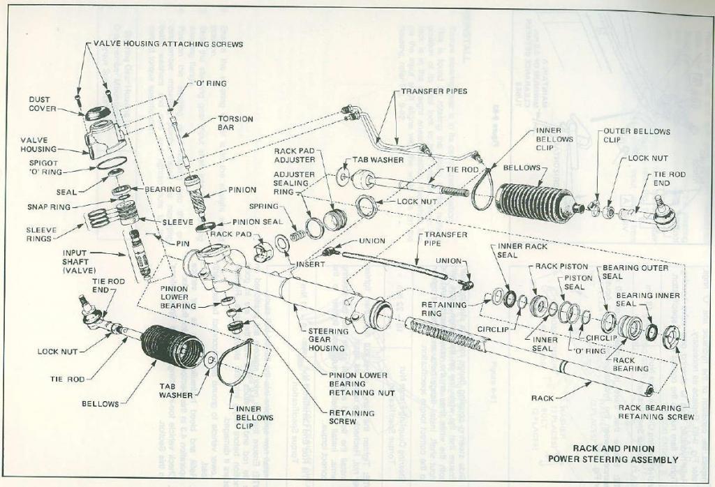

August 5, 201312 yr Author VL_POWERSTEERING_RACK_DIAGRAM.jpg Just wanted to post this diagram for everyone's informational benefit. Awesome, thanks caspice! So is the adjustment bolt you were referring to called "Rack pad adjuster/Lock nut" or "Lower bearing retaining nut/screw?"
