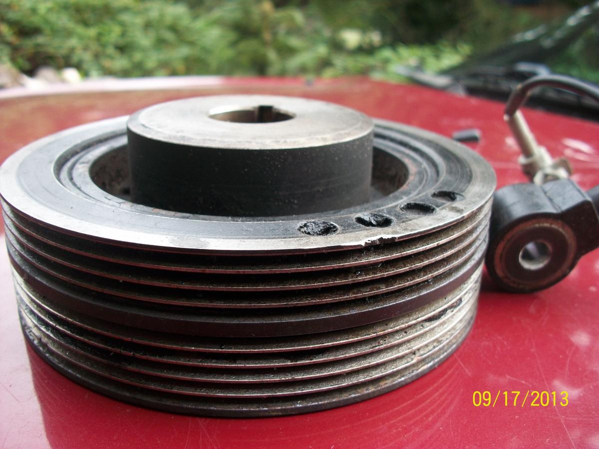

September 17, 201312 yr I have a pulley and a knock sensor from a 94 Impreza EJ22 you can have for free if you are still thinking about fixing your EJ22? A couple of small imperfections as you can see, but still in working order.
