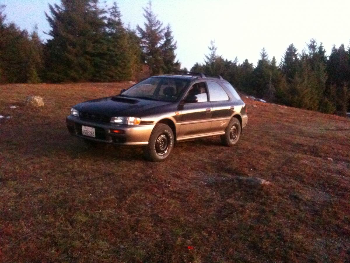

Hi there, If you do a 6" body lift there is no need to cut fenders like I have, you can run 235's if you bash the hell out of the inner fenders. I have just stopped rubbing completely. took a lot of hammering. As for buying vs building a lift. If you are a decent welder, you can do it all yourself. if you arent a welder, but have a drill press and a cutting saw you can build the subframe spacers yourself and save a couple hundred bucks.

Never can tell.
Lol...you funny Zap.  Making me jealous by showing me pics of my dream grocery getter. Love the look of those rims over stock.:drool:
