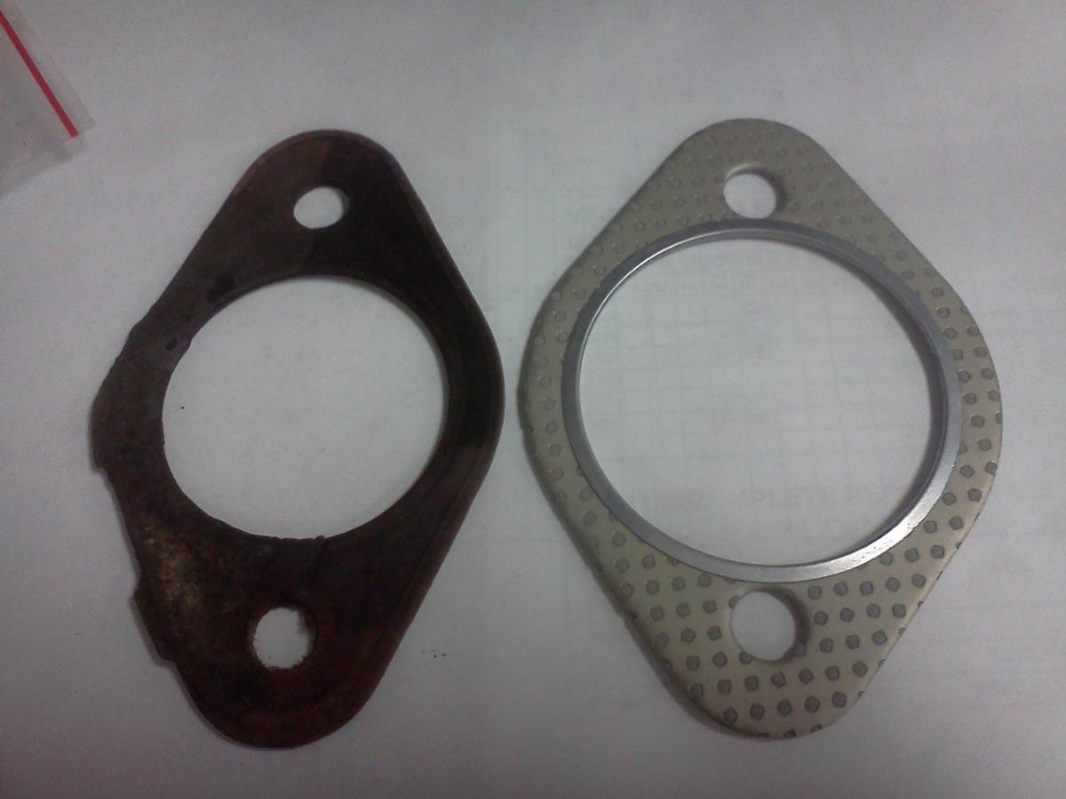

yep...nothing I find matches.  85 Brat.  every parts search comes up the same...a simple  doughnut looking gasket.  Felpro 91443.  Search on line, Autozone, Orielly, etc...all list and show a basic round gasket for the head to manifold.
But what came off my engine and what is depicted in the Haynes manual is a gasket with a pair of bolt holes.  Basically looks like a typical thermostat gasket.  But no auto parts place matches this in their system.
what gives?  I see nor feel any recessed area on the head or manifold that would hold and retain a ring gasket that lacks bolt holes.

well, got my gaskets in from Subaru...44022GA330....
not it.  the ring is too wide.  I brought my old gasket in and they couldn't match it.
gonna have to try NAPA next.
the gasket that came off my brat had the port opening 1-7/8" and the bolt holes were 3" across.
the exhaust port opening on the 44022GA300 gasket from the dealer was 2-1/4" wide.

here is a pic...the 44022GA300 gasket from the Subie dealer is much larger and would barely seal I think...the metal ring is right on the edge of the flat sealing surface around the exhaust port.
ok...so the pic upload didn't work...lol
That gasket they gave you is the head to 'manifold'. You want the pipe to manifold which is the Fel-Pro # and the inner opening on it is slightly bigger, but not enough to cause any sealing issues.
try getting one for 75-79 1.6 ea71 as it had no intermeadate exhaust air suction valve thingy in the way the gasket they give you is the one for that piece Have been up against this wall before dumbass parts books
it sounds like Subaru has the verbige all backwards...anyway, it's not exactly a rare part...how has something as simple as an exhaust gasket gotten so messed up in the parts world?
