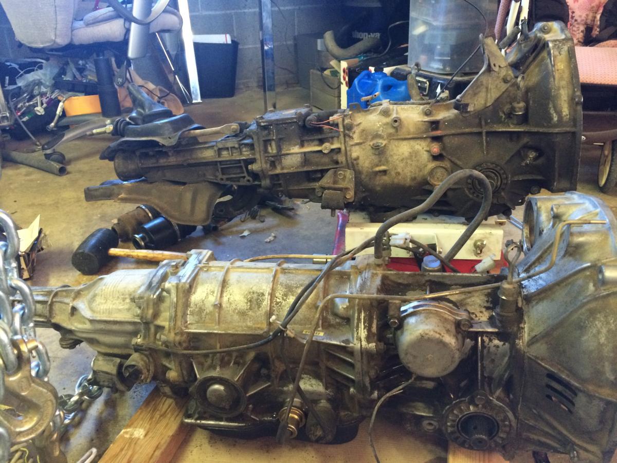

April 4, 201511 yr Heres a handy pic thats on my phone of a 4 speed s/r i recently yanked. Its looks very long and slender compared to the 5 speed. Thats a 3at next to it sorry its what i have. Obviously the push button will be a single range with a non mechanical linkage. Edited April 4, 201511 yr by ihscout54
April 7, 201511 yr Author nice..i have a single range 4spd skeleton in the garage.found it from a guy on craigslist who said he saw it sitting in the scrap yard and snatched it up. it had the same dimensions as the dual range and looks identical except fore the d/r assembly and linkage but geared lower. i actually transplanted the gear assembly from thne single range into my dual range and it now has a slightly lower gear ratio which is great for compensating for the 26'' grabbers. only problem is no 5th gear. we need a pic of the dr and single range 5spd together. hope someone has one here

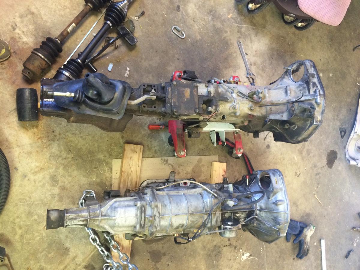

May 14, 201510 yr Author SHES FINALLY HERE!! got it this morning. looking at the differences so far it seems like i need to lengthen the drive shaft and find a 24 spline clutch kit. the old shift assembly from the 79 wagon seems like it will work with a few cuts and welds to modify it. donor was an 85 wagon 5speed dual range.
