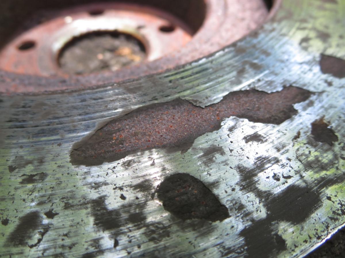

as the weather warmed up, my 2001 OBW started vibrating under braking. like i imagine a warped rotor would feel. in the last couple weeks, however, it's bad enough that i can feel it in the steering wheel and it causes the brake pedal to pulse. so i finally had a peek at it today. i pulled the driver side caliper and rotor and found that the rotor is clean on the outside, but pitted and rusty on the inside. the caliper slides nice and smooth but the pistons are tough to move in. i'm using one of those quick grip type clamps to push the pistons in. they will push out when i press the pedal so they're not completely frozen. the brake pads look the same as far as condition/wear. it doesn't make sense that on a caliper like this, the inside pad would NOT be causing some wear on the inside face of the rotor judging by the smoothness on the outside face. doesn't the inside have to contact in order for the outside to contact?

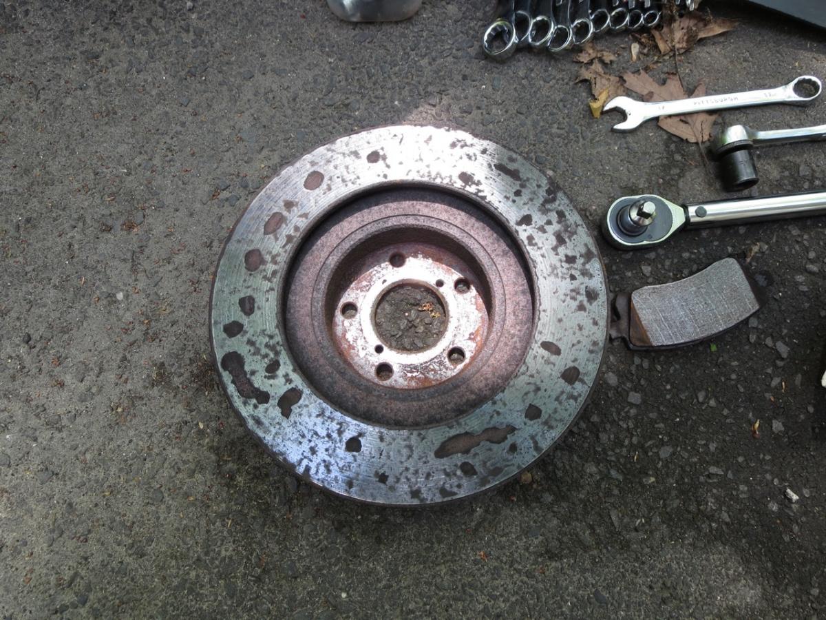

still plenty of meat on the pads as far as i can tell. the rotor looks like it was wearing at some point, then it just never got touched again so the forces of nature chipped away (literally) at it to make it what it is now.
Well with plenty of meat left on the pads, you may get lucky, and not need to address a caliper repair or replacement. Put on a new rotor, and drive on. Old rotor may have been made with bad steel. Probably a good idea to keep an eye on that rotor replacement. If you feel any braking with foot off the brake pedal, or smell a hot brake pad, then you can get suspicious that the caliper is a problem. It would be nice to check the temperature of the rotor, after driving for a while, with a heat gun (with digital read out), to see if there is any high temperatures at any of your rotors.

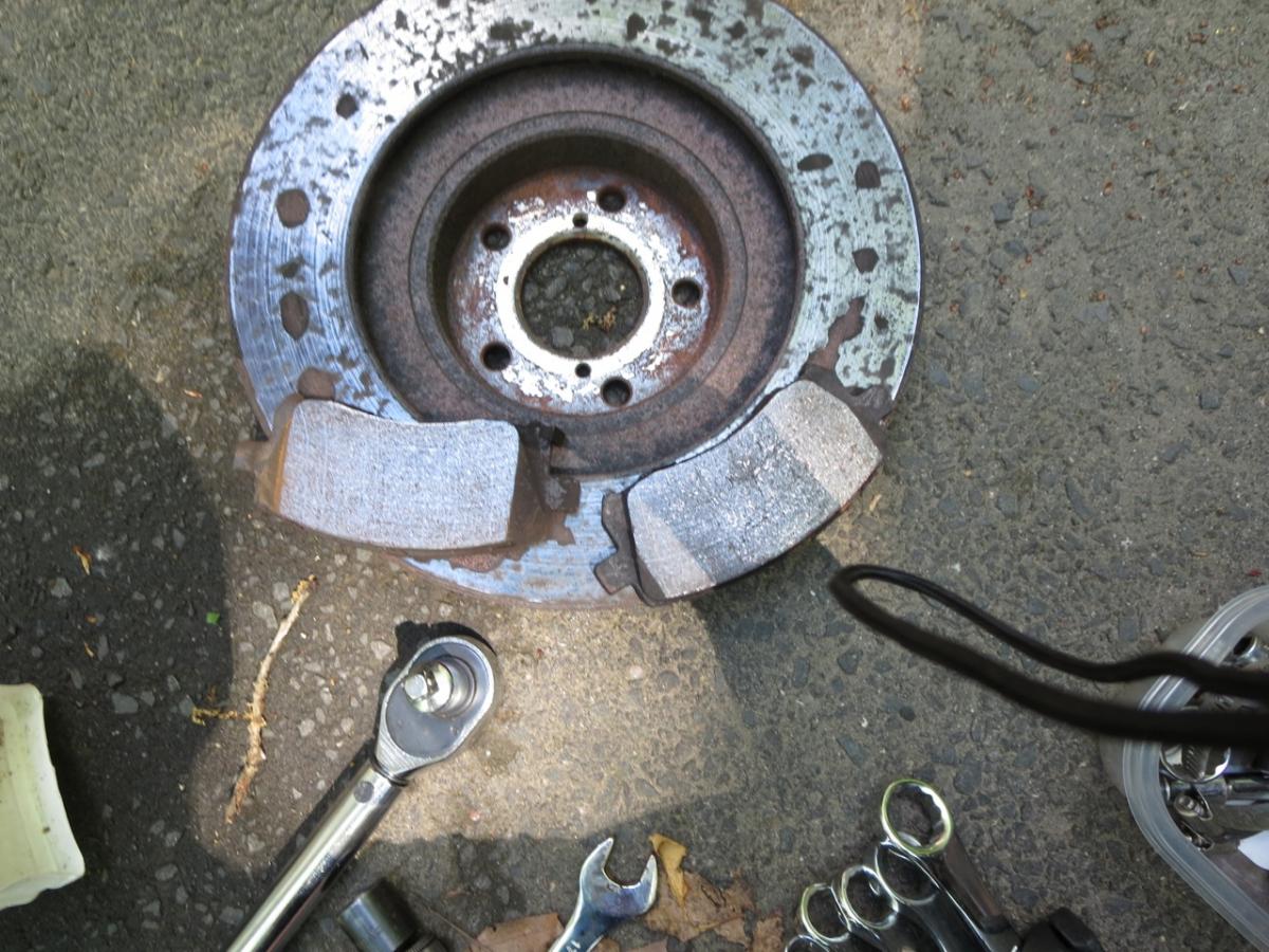

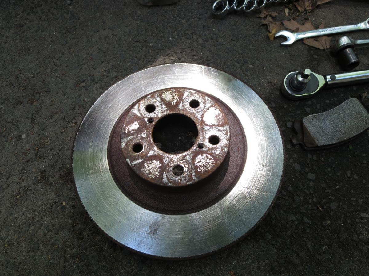

picked up a couple of new rotors and layed them against the old ones and couldn't really tell what was warped. maybe the part that contacts the hub? anyhow, issue is fixed for now but i'm gonna keep an eye on things and plan on servicing the brake system soon.
Not a caliper issue.
The inner side of the rotor got too rusty and the pads aren't making even contact with the surface. The heavily rusted areas are where the pads can't make contact at all. Usually that starts as a small area only 1/8-1/4" wide on one edge and spreads from there.
All of that is probably from when the car sat for so long. That will lead to vibration as the other surface of the rotor creates more heat during braking.
The amount of warp or thickness variation necessary to create a vibration is not visible to the naked eye. .003" is usually the limit for rotor warp. .006" will cause the steering wheel to shake bad.
that's a terrible rotor - did that car drive through salt slush and then get parked in grass during the time it sat?  i routinely see rotors completely rusted over from sitting, then drive them for awhile as the pads wear the rust away, never seen that happen.
i'd just replace the rotor, caliper is probably fine.

you could check to see if a local place will turn your rotors as well, they can turn that back down to flat if it's new it should still have enough material available for that.
feel free to replace one rotor at a time, replacing in pairs is in no ways beneficial, i routinely replace only the bad rotor.
had both front rotors replaced sometime in the winter then parked it in the driveway for a couple months.
both rotors looked identical. i'm keeping the old rotors for just that posibility.
