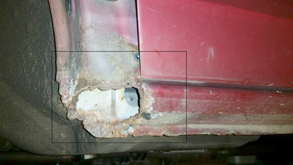

DaveT Posted November 27, 2015 Share Posted November 27, 2015 Decided it was time to investigate the rust bubble on the lower left bottom of the fender in the mud flap area. Too late. I have to check my parts car, but I'll be surprised if this area is intact. Anyone have a wreck with this area rust free? Or only lightly rusted? And have a way to cut off a section and ship it? It sucks that the design of the plastic, mud flap and metal is so effective at trapping water and dirt so well. Part of this repair will be changing that. Quote Link to comment Share on other sites More sharing options...

DaveT Posted November 28, 2015 Author Share Posted November 28, 2015 Ill try marking up a picture and posting it. My retired car is rotted out about as bad in that area. It was rusty as heck when I got it, I considered it a beater, and ran it a lot longer than I expected. This red one, is still mostly rust free, except in that fender rust making pocket. I have not opened up the passenger side, but I'm thinking it may be pretty bad also. Quote Link to comment Share on other sites More sharing options...
DaveT Posted November 28, 2015 Author Share Posted November 28, 2015 Here is a mark up. Roughly the area in the square. Before cutting, or even fully removing the fender - remove the lowest bolt, in the flange at the bottom. I think the hole is barely visible in the picture. Remove the bolt above that, hole is visible behind the door. With the door fully open, a 3/8 drive 10mm socket can get it. Remove the bolt near the top, that is hidden by the door. 10mm combination wrench with the door fully open, if you don't want to bugger up the paint on the edge of the door. At this point, you may be able to move the fender away enough to see if the underlying frame is still there, since that is the part I'm needing. The mud flap mounting screws may have to be removed if things are still intact. The outer layer is the hardest to re create. the inner pieces, if they become too difficult to cut out, I can fab from sheet metal. But it might be just as easy to cut the section out, since they are spot welded along that flange on the bottom. Quote Link to comment Share on other sites More sharing options...

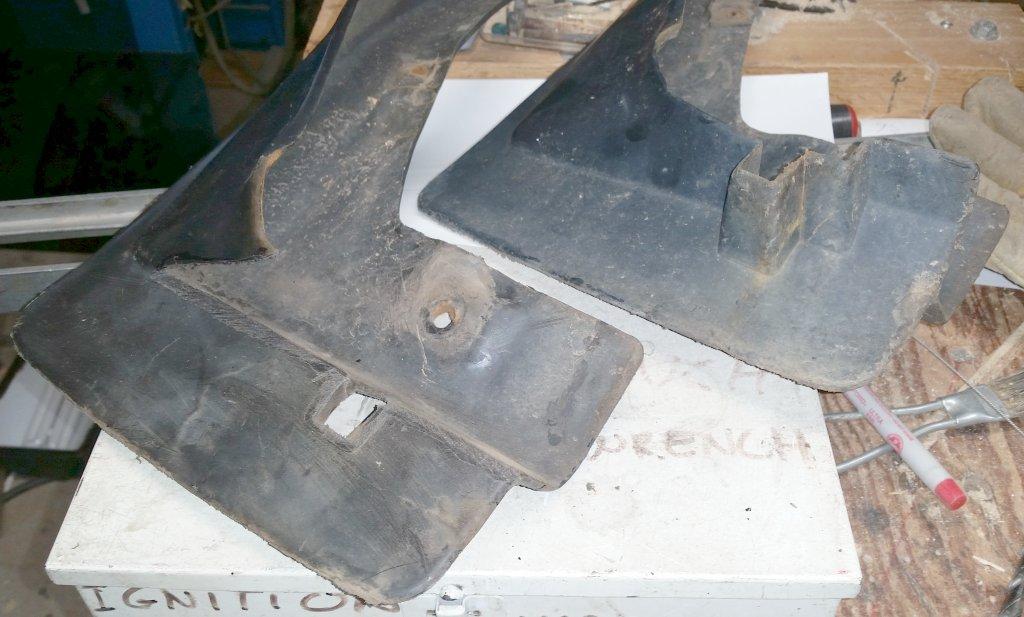

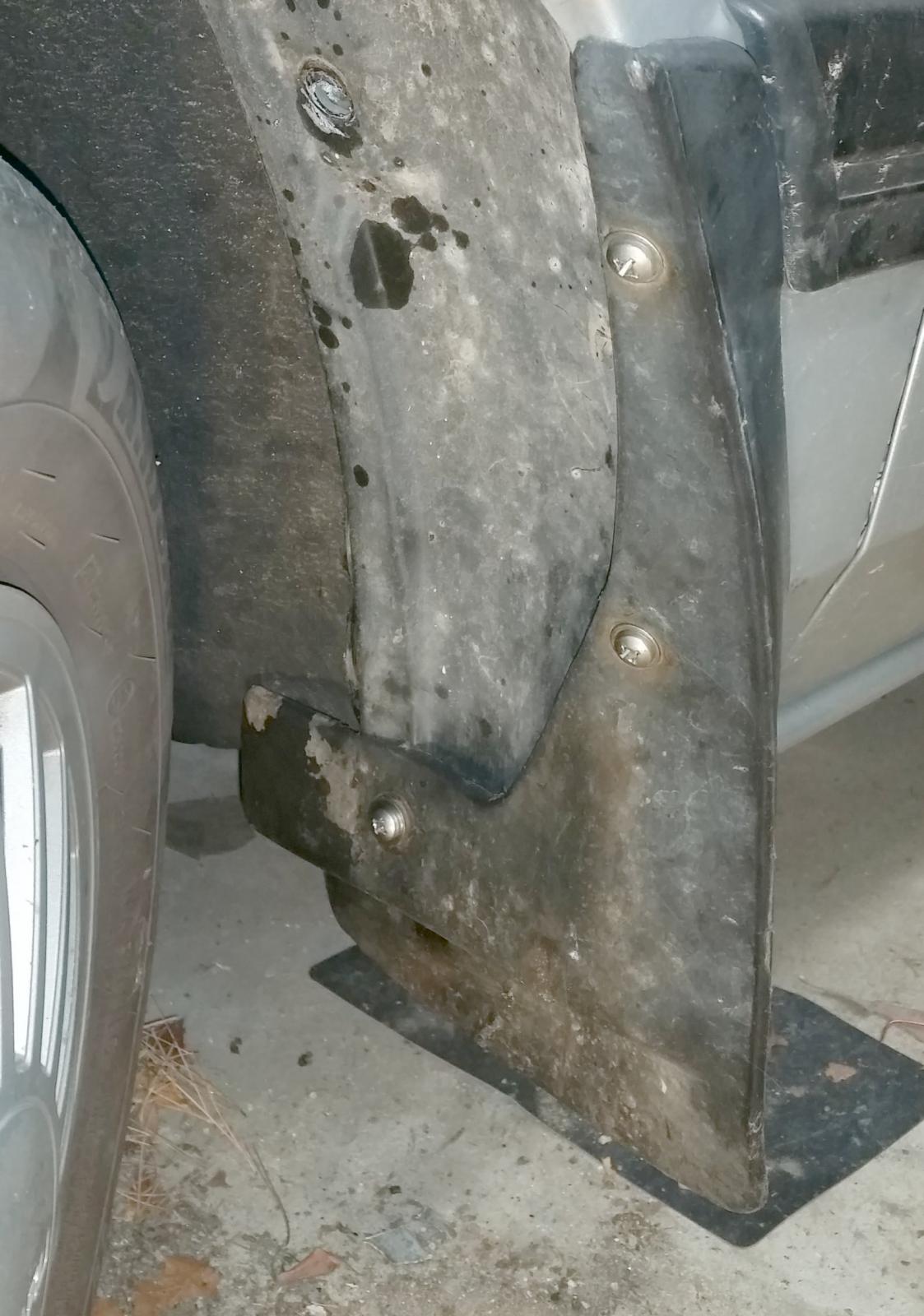

DaveT Posted November 30, 2015 Author Share Posted November 30, 2015 Decided to look at my 93. WAY better condition, but the design that traps dirt and moisture was doing it's job very well. This is step one of my modification of the mud flap. Step 2 is to close up the square hole that allows water and dirt thrown back and up by the tire to get right into the pocket formed by the flap and the sheet metal. Quote Link to comment Share on other sites More sharing options...

DaveT Posted November 30, 2015 Author Share Posted November 30, 2015 I was going to wait to see if your parts car was intact in that area. If not, or its too far gone, or you discover you need it for your car, that's ok. It's a hidden area, so I can make up something to patch it. I am also modifying the mud flaps and the fender to remove the pockets that crud collects in in the first place. Quote Link to comment Share on other sites More sharing options...

DaveT Posted December 1, 2015 Author Share Posted December 1, 2015 Ok thanks for looking. The 93 I got from CA is in amazing condition in that area. It was full of dirt, but no damage to the paint or rust yet. Have to mod the other side now. 1 Quote Link to comment Share on other sites More sharing options...

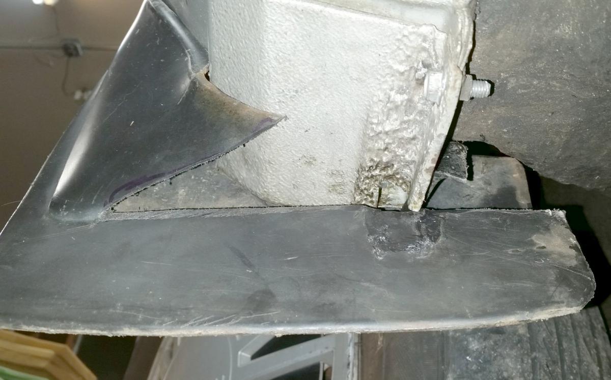

DaveT Posted December 1, 2015 Author Share Posted December 1, 2015 Mud flap mod continued. Also requires snipping a bit of the fender flap that goes down under - just enough so it does not have to go through the square hole in the original mud flap, which I have welded closed using pieces removed to eliminate the pocket that dirt collected in.The snip also leaves an opening behind the flap that debris can drop out of, instead of being trapped inside between 2 layers of sheet metal. Pulled the right fender off of the 87 tonight, the rust is bad, but at least there is metal still there.... 1 Quote Link to comment Share on other sites More sharing options...
