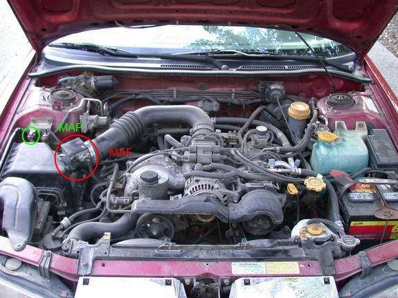

I'm fairly sure those have a MAP, mounted over on the RH strut tower. I know a '96 does, and while the '95 ECU is a unique animal, the rest of the management is pretty similar. With or without, a vacuum leak can cause problems (letting in air after the MAF = low reading at the MAF = less fuel).
A '95 2.2 does have a fairly primitive OBDII, it would be worth hooking up a code reader and looking for stored codes, and watching live data of the TPS, MAF, and O2 while acting up. Probably way easier and more accurate than trying to read it with a scope.
Also, a pre-O2 exhaust leak can throw the reading off....make sure the manifold gaskets aren't blown out, and all studs/nuts are present.
Do you mean MAF instead of MAP? Cause the MAF is above the right strut tower, I can't find a MAP anywhere.

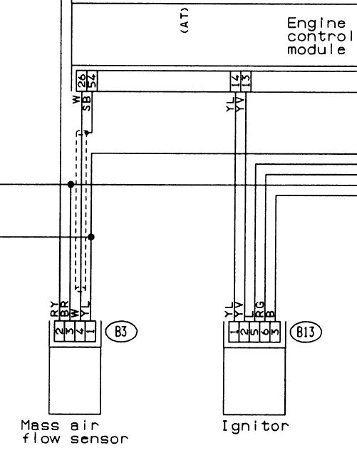

MAF pinout:
Pin 1 Connects to Batt+ when the main power relay comes on when the ignition is on
Pin 2 Connects pin 1 of the TPS and pin 2 of the Coolant Sensor and connects to pin 25 of the ECU
Pin 3 Connects to engine ground
pin 4 Connects to pin 26 of the ECU, and the shielding jacket around the pin4-pin26 wire connects to pin 54 of the ECU
I read the schematic and this appears to be the way the MAF is wired.
I'll first check to make sure pin 1 is Batt+ with the multimeter. Then I'll check that pin 3 really is grounded. Pin 2 seems to be either a solid positive or negative charge switched by the ECU so I will investigate that. And pin 4 seems likely to be sending some kind of signal or voltage or current reading.
Yes.
Pin 1 = 12v batt supply
Pin 2= 5v ECU reference
Pin 3= ground
Pin 4= signal voltage to ECU
Pin 4 wire is sheilded to prevent interference. Sheilding is grounded at the ECU.

Nope, they have a MAF and MAP

95 was a weird year. Some just had a MAF, others had both MAP and MAF.

We took out the engine today, there is no MAP sensor on his strut tower like there is in your pic.

We disconnected TPS and nothing changed, car drove ok without TPS but hesitation showed itself occasionally just like with TPS connected. No CEL even with disconnected sensor.
We disconnected MAF and nothing changed, car drove ok without MAF but hesitation showed itself occasionally just like with MAF connected. No CEL even with disconnected sensor.
We will wait till bluetooth scanner comes. Might play with disconnecting the Oxy sensors and temperature sensors tomorrow.
Feels like a loose wire shorting something and putting the ECU into idiot mode. We took off the passenger carpet and foot plate and found the ECU, no corrosion or signs of water intrusion, no wires appeared frayed or tampered with.
We keep looking everywhere we think important wires are and checking for frays/damage/water/tampering.

I'll have to check the 5v line to MAF TPS and Coolant Sensor tomorrow, since it seems to be trying to idle and acting oblivious to driver requests.
