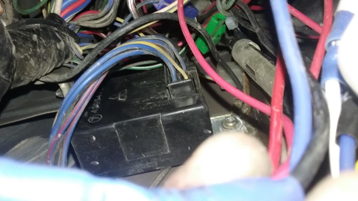

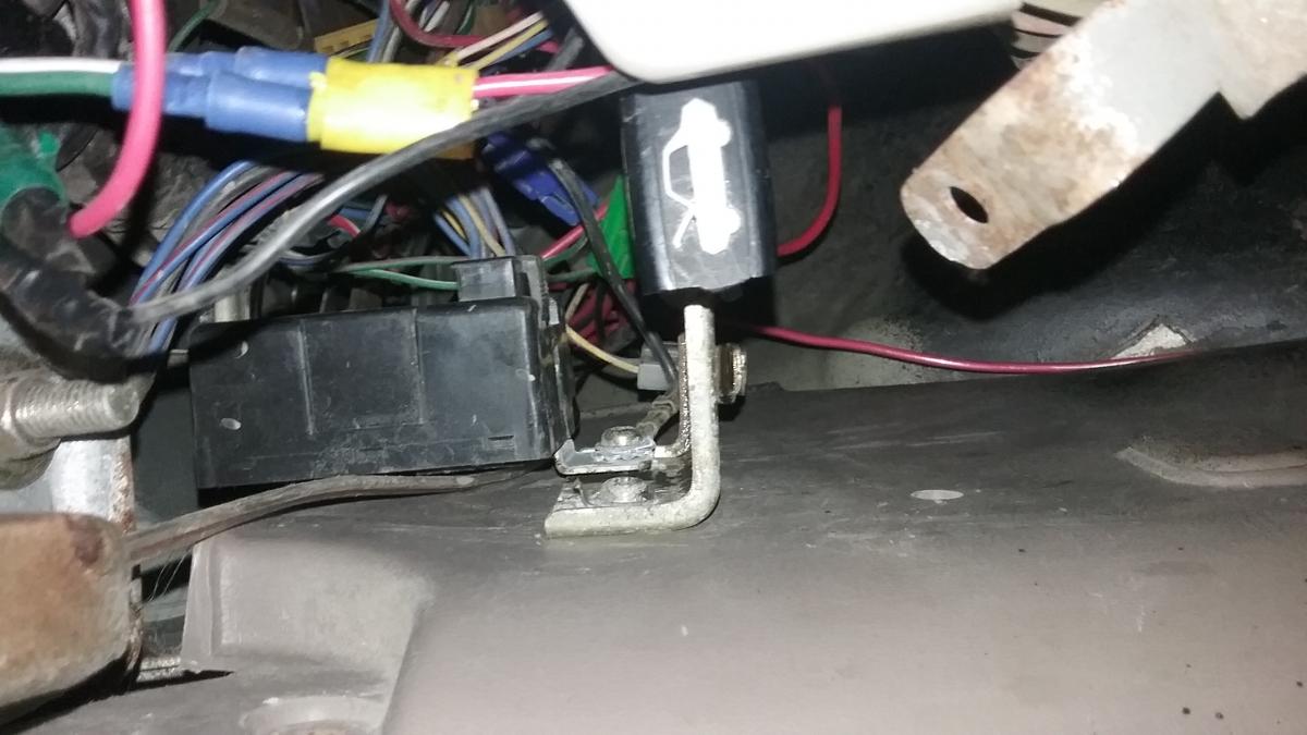

Ive come across this black box with a mistibishi emblem on it while trying to track down my voltage issues, what the heck is it, and why are there darn mistibishi parts in my subaru ????
