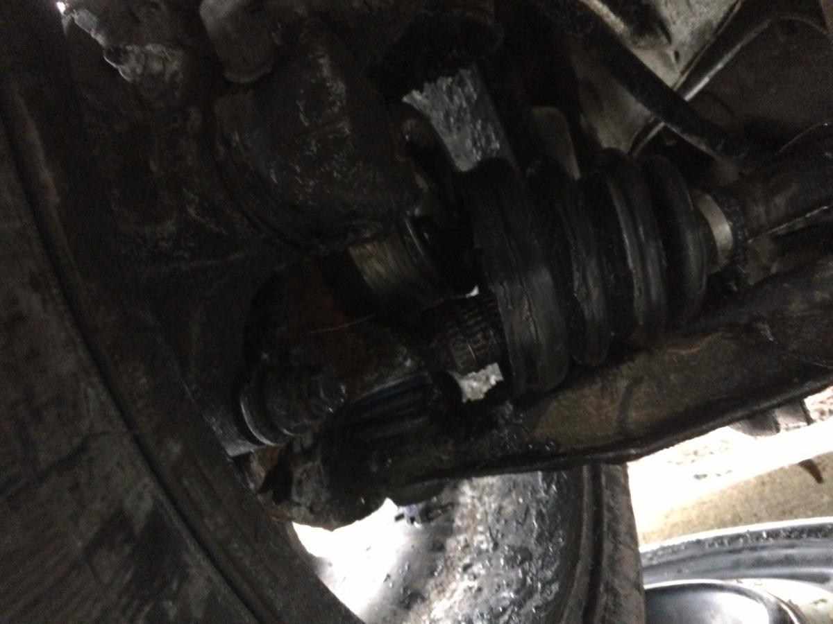

Blown axle and no tools...AKA as if I needed a reminder why I avoid aftermarket axles
Installed an aftermarket axle that someone had in January...I don't do this often but sometimes they're just available and why not, they can't all fail, right?
50 miles later on the interstate the axle blew out of the CV cup.

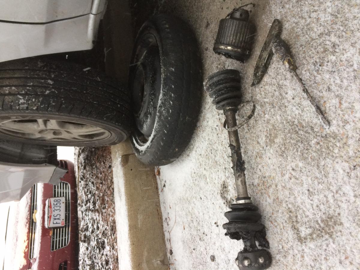

No jack and very few tools - luckily I had a knife and screwdriver.
Drove up on curb - with the broken joint it couldn't push the car onto the curb so I used the spare as a ramp.
Cut inner joint and popped the circlip out, pulled it apart insitu on the trans.
Got it locked in 4WD.
Finished the 120 mile round trip in RWD.
I had been given two new axles, I tossed the other brand new one in the scrap pile, it was a different brand but it's not worth my time.
Never had an OEM or FWE failure, although that's what i use on lifted subarus and used to drive them 50,000 miles with cracked boots and noisy joints.

I got lucky or maybe it separated and just rotated inside the CV on the interstate but not until I took some sharp turns off the exit ramp did it give enough room to pull completely out of the joint and then flop around, by that time at slow speeds.  But yeah - if it pulled out on the interstate i imagine that would maybe be ugly those axles are heavy to be flopping around with all that length/leverage too.
