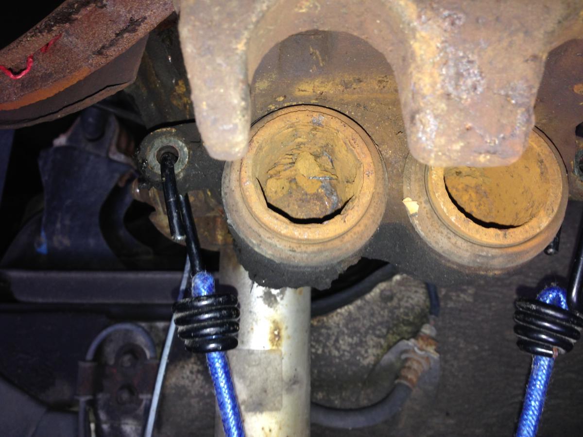

I finally after having our garage snowed in, was able to pull the wheel, and examine the caliper today. One slide pin worked fine, the lower one was frozen. It took a pliers and brute force to move. Once out, the good one was lubed, the bad one was bone dry.
Next once I got the pads out I found the backs of the pads against the pistons to be very rusted and the insides of the Pistons to be full of rust or dirt or both. One had rust inside, the other looked like a pipe that corroded down to 80% of its capacity.
So from here, should I clean the insides with a wire brush maybe on a dremel, or just clean away the loose debri/rust, or replace the caliper. Nowhere locally can I find a rebuild kit that includes new pistons and we have all the major chains. Subaru tells me they discontinued caliper rebuild kits.

Don't worry about rust on the inside of the pistons.

Thank you for your informative reply. Should I try to remove the loose rust? I'll try to attach an image.
For some reason the image is upside down, just an FYI.
if the piston boots are fine - ignore the rust and reassemble.  sometimes i'll knock the loose stuff out just for kicks
that is surface rust and entirely benign. those pistons are thick and will never rust through before something else fails.  the bore and parts of the piston you can't see are the critical areas and covered by the piston boot.
i've driven many years with even slight cracks in piston boots.  if you have a cracked piston boot then replace with a used caliper.
if you're up for a little extra grunt work you can rebuild the caliper.
even if the boot was torn i'd just assemble it as-is for today and plan to deal with it in the next two years, get your parts ready, etc.

I've done my own car repairs on my vehicles and friends and family for 50 years, and have cleaned up many calipers that were seized or sticking. The only time the piston needs replacing, is if its badly pitted on the surface that slides into the caliper past the piston/caliper seal. Bad pits on that surface will cause fluid leaks. Rust on the rest of the piston is a non issue, as long as the end of the piston that pushes on the brake pad is relatively clean and level.
I have never had to replace a caliper on any car I've ever worked on. A piston or two, yes, but it is rare to see one bad enough to replace.
As long as the Pistons move freely knock the chunky stuff out and put it back together.
If you're worried about further rust use a dremel or other wire brush tool to remove the major stuff and wipe the inside thoroughly with antisieze compound.
