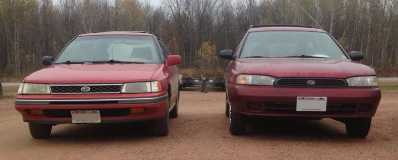

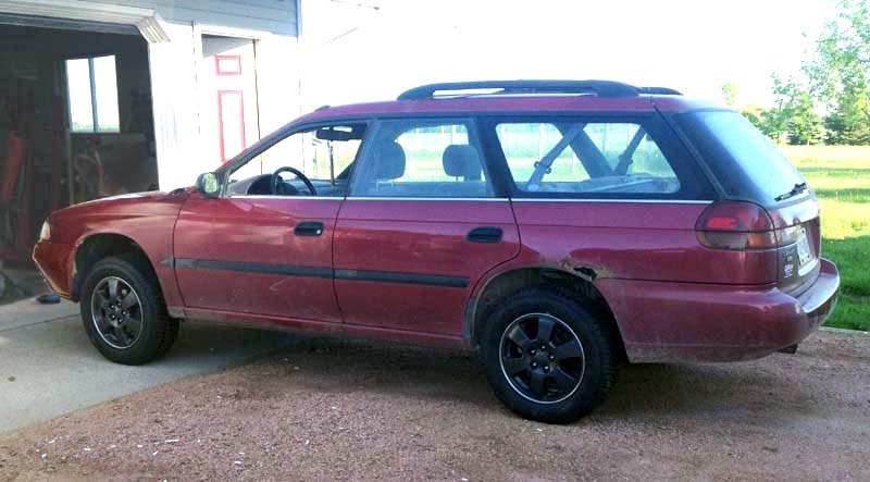

April 17, 20197 yr i also have done the Forester strut lift on a 95 Legacy wagon - on the stock 14s it nets very close to 2 inches of lift with no other work add the 15" Forester tires and you can gain just a little bit more the 1st pic below is of my stock 90 sitting next to the 95 with just the strut lift, sitting on the stock tires/wheels. Look at mirror positions to really see the difference - before the strut lift they were dead even at the mirrors. 2nd pic is with the forester wheels mounted.
