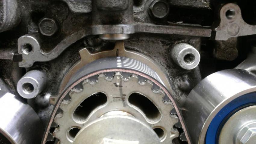

The trickiest part is to line the mark on the crank pulley up.  It's not the super obvious arrow.  There is a small hash mark on the flange that needs to point up at a non obvious hash mark.
here is a picture of the crank pulley - note it is the mark on the BACK side (behind the belt) that you need to line up correctly
this one does have a mark on the front, but not all have that.
there are similar hash marks on the cam pulleys that also need to be aligned properly - everything should be pointing straight up (ie: 12 o'clock)
