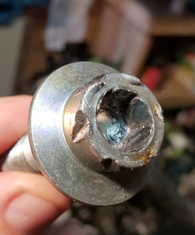

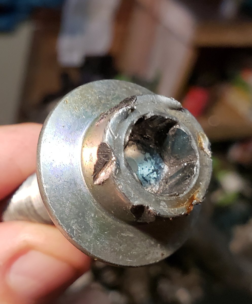

3.  Cam sprocket bolts - again I suspect that heat played a role here but I had to drill all four of them and even after drilling past the bolt heads with cobalt bits, it took a 3 foot breaker bar and nut extractors to get the bolts off.  Attached is a pic of one of the cam bolts.  Lesson learned: buy the avcs cam sprocket tools.  I broke an old timing belt in four places trying to hold the cams in place with vice grips...so I wont try that method again.
