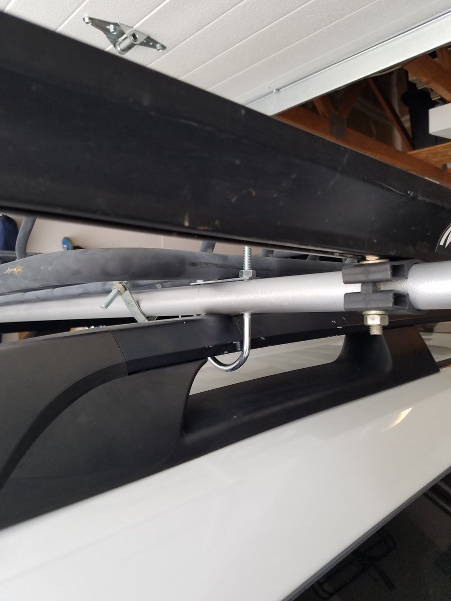

June 30, 20187 yr if you get them out in one piece, make sure you put some sort of loctite or something to keep them from rusting again. I wasnt able to put mine back on. Though, I ended up using 1" conduit and Ubolts to recreate them. work pretty solid! -Justin
