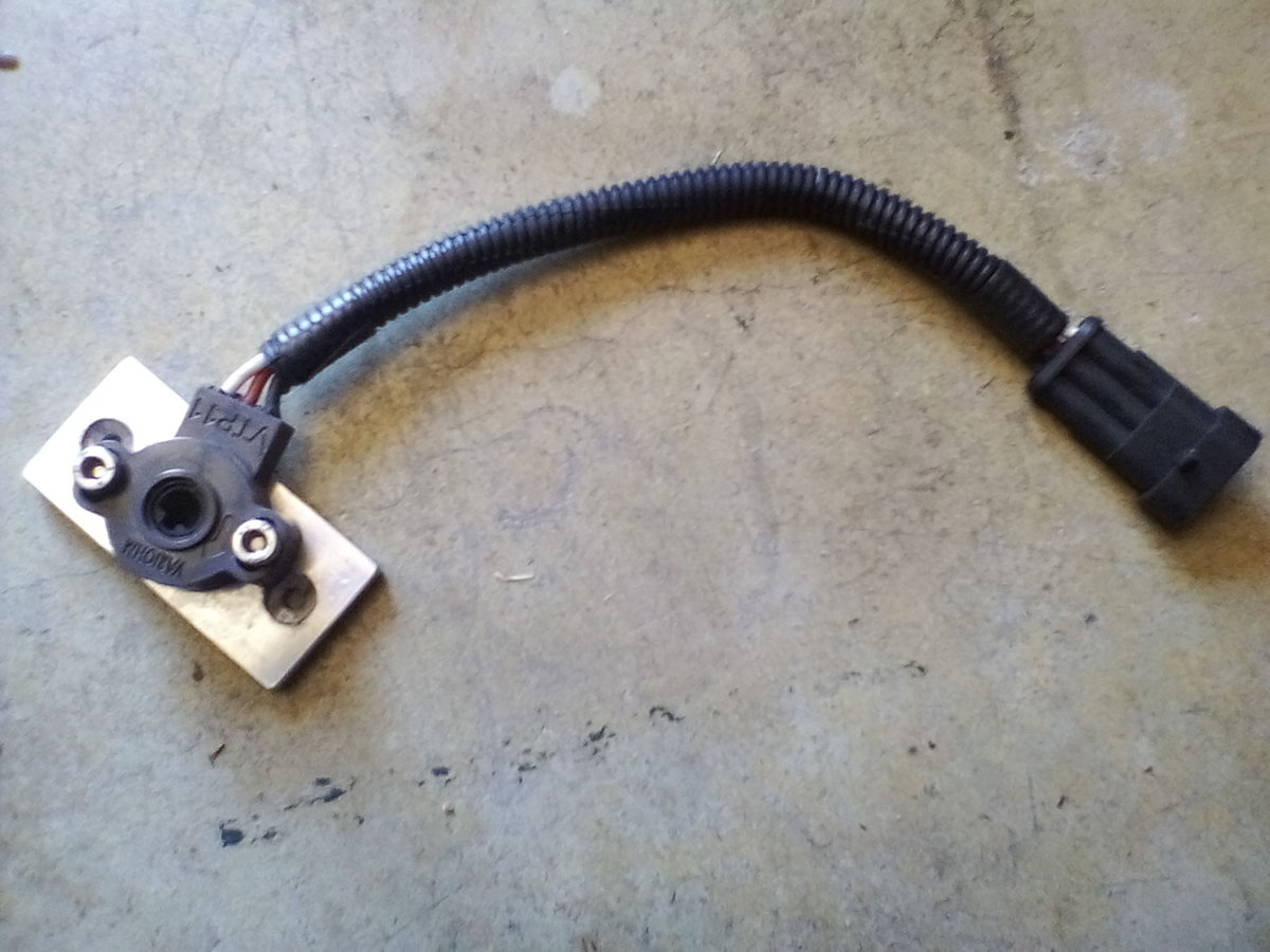

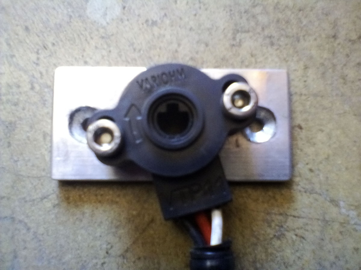

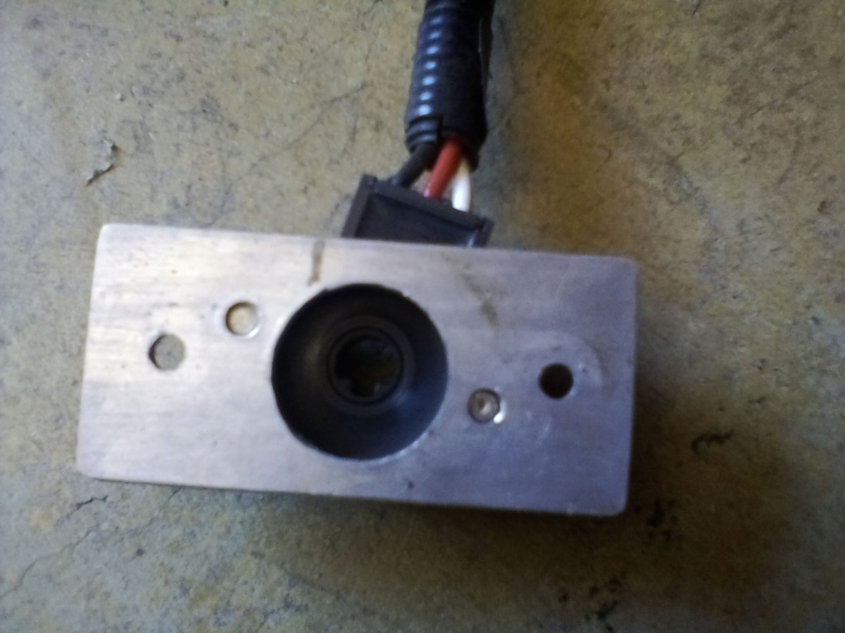

Here is a pic of the VariOhm universal any which way TPS and adaptor I made for my flat manifold throttle body to work with my Peel Instruments Lean Bias Logic Propane enrichment unit. It runs the same 8 mm throttle shaft with D flat profile as the Subaru EA throttle bodies
