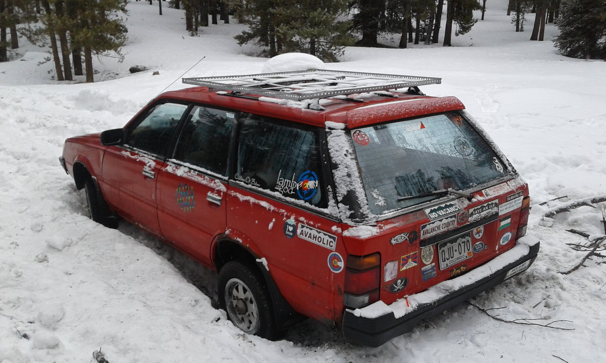

Have a look at this gaudy roof rack:
I once put a canoe on this thing, 115 lbs and just ratchet strapped to the bumper it came with the car and was held together with nuts and bolts. It was rather crappy but to its credit it did a fine job. So yours should be more than adequate.

It should be an awesome time! and I like the "crappy" rack on your ride, looks very utilitarian. Is it connected to more than just four points on the car? I'm thinking part of my solution might be to somehow connect to the other tracks on the roof to further support and stabilize the load. I'm just nervous that with a 20 foot, 100 lb Kayak, plus a 16 cubic foot, 200 pound Roof box, I'm going to hit a bump or a strong cross wind and have my roof rack blown off the top of the car.
Yes, there are blocks bolted to the front bumper.  The X made with the red straps is needed when carrying long heavy loads.  And also for  sheet goods, that will catch a lot of wind.  They hook to the towing hooks and the tops of the vertical supports.  With the X straps in place, you can grab the rack anywhere and shake the entire car with it.  Without them, the rack could twist off.  They also prevent wind that inevitably gets under the load from lifting the entire thing off the car.
I don't trust the factory rack mounts to hold a lot, they are only small screws into sheet metal.
The front section is pinned to the main part, so it can be easily removed when not in use.  It is all aluminum, with stainless hardware, because I didn't want rust stains all over the car.  Do use anti seize compound on them, or they will corrode and NOT be disasembleable in a few years.
The 4 vertical load supports that go into the rain gutters have a piece of vinyl tubing cut to make a pad to prevent the metal cutting through the paint.
The aluminum is 1" x 2" x 1/8" wall tubing.  I used 1/8" sheet to make the vertical supports for the back section to rain gutters, 6" wide into the gutters.  L brackets 1/8" thick tie the cross members to the OEM rack rails, using their nuts.  I doubled them by using a set from a scrapped car, so there are 8 tie points to those OEM rails.
