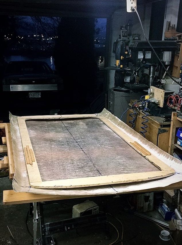

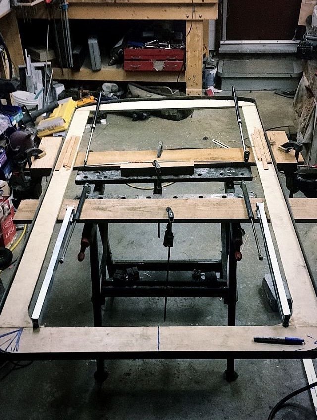

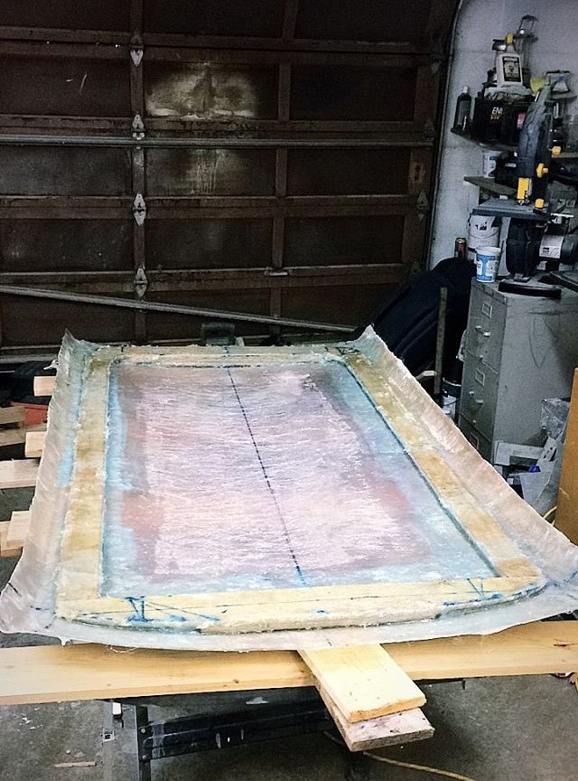

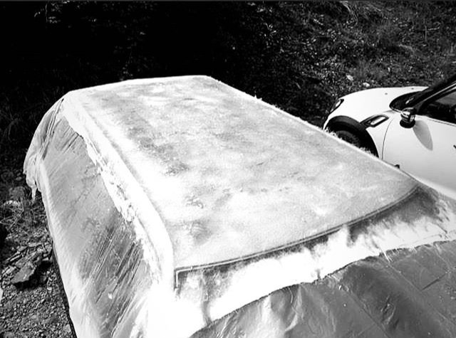

Some of the pop top construction
used the roof as a mold. Trying to make it look like there is no poptop!
7F5A74DC-77C2-471F-9420-79575AB72E1B.thumb.jpeg.9e8310947ff066a075e3303a21c356e7.jpeg9780692D-A0D1-4594-8F90-699079E5898F.thumb.jpeg.1164c38db0f4e4afb4d0371f088e0954.jpeg
Here is the wood Frame for the shell and the metal frame for the car with the lift mechanism,
befor install.
