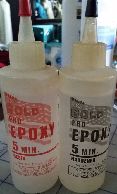

April 21, 20196 yr got this stuff from my local hobby shop - it is meant for building balsa planes, but it has worked great on everything I have tried it on to date, including a styrofoam plane, metal & multiple types of plastics. fixed a pair of scissors recently with it - the blades were coming loose & moving around due to cracked plastic. they don't move around anymore. it does not take a lot either. as you can see levels in the bottles.. and I have used this stuff a LOT. simple 1:1 mix ratio makes it a snap to mix up, and yes, it is pretty much set in 5 minutes
April 23, 20196 yr Author Update: Before I had a chance to shop for the "USA Gold Pro" or even get a fresh tube of cyanoacrylate (and thanks for the baking soda hack - never heard that one) a friend laid a tube of LePage Marine Epoxy on me. I tried a test spot on a spare headlight and the bond seems to be strong, so I'm trying it on the Forester's headlight. The only downside of this stuff is that it has a long (2 hr) set time, so I had to tape the broken spud in place, as the epoxy wasn't tacky enough to keep it there and it kept falling off (grrr...). I'll give it a day or two to cure and see how it looks. Btw, I didn't have to do anything with the mirror - it was smashed so it just got replaced from the boneyard.
