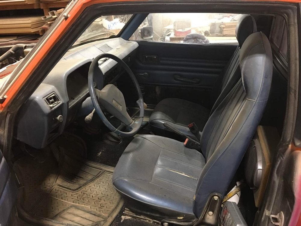

Hi I have a Subaru Brat, the odometer reads 76540.3>4
there is no one hundred thousandth place, is the a way to tell if it has hit 100,000?

Not truly but there are indicators which would tell you it’s not rolled over yet.
How do the pedals look ? Is the “Caution” decal still in the drivers door ?

any steering play? balljoints? lift a wheel off the ground and see if it has any play, check to see if they are the original balljoints.
pictures would help alot as Moosens has stated, how much seat wear, seatbelt, and the rubber on the pedals,
original clutch cable? originals seem to always go out around that mileage if it is truly at 75,000mi.
alittle harder to tell with this one but check the brake pads and see if they're still the original with the fuji heavy industries stamped logo, but that's not a guarantee either.
a 75,000 mile brat is very possible since mine is only at 68,500miles right now.
