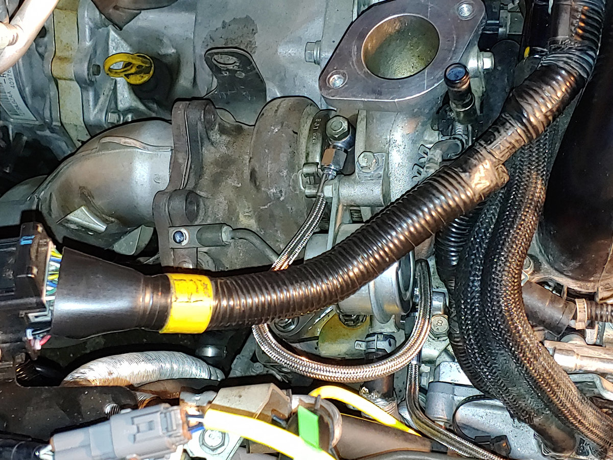

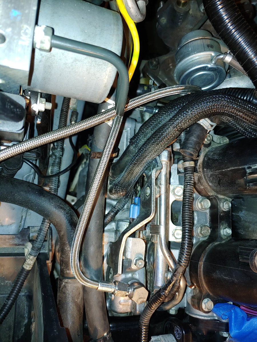

I forgot to post pics of the new oil lines. yes I had to dremmel a bit of the front heat shield off to make this work better.
Here's a pic of the turbo line.
Edited by Sonicfrog
