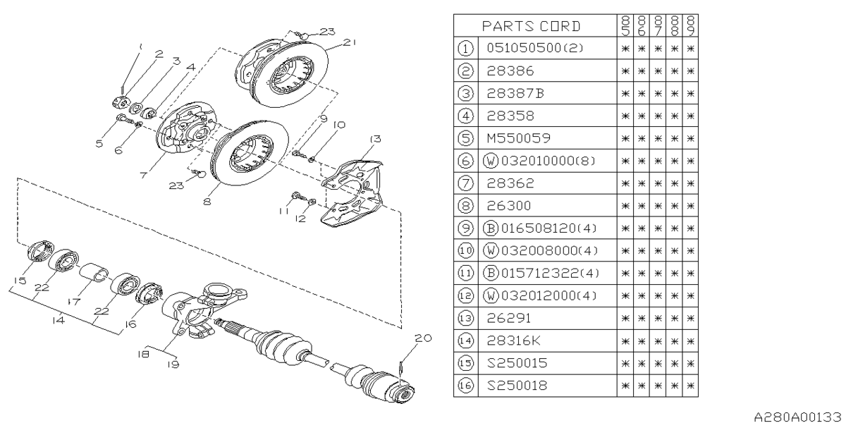

Also been hearing some grinding in the front end on the passenger side. I need to track down a complete front passenger side wheel assembly (bearing, hub, spindle).
If anyone has these parts for sale, please let me know, I need the corner light to pass inspection which is coming up soon and from the sound of things, also need to replace the front passenger side wheel assembly ASAP as well.

On the other hand, as far as the passenger side wheel assembly, what indicates that you need to replace the entire setup? Have you considered just replacing the wheel bearings, or is there some type of unrepairable damage to it?

with the passenger side front wheel assembly, it's probably just the bearing, but had some difficulty in the past w/ don't just the bearing, and not the hub as well. figured the spindle might come with it, and would rather not chance it and generally make it easier to replace.

The bearings on these are relatively simple. I have replaced them on all wheels on my loyale, and they are identical to what your DL uses. I'm not sure what spindle you are referring to since the axle shaft passes through the hub/bearing assembly. It is a press fit application, so if you have access to a shop press or a reputable shop, you should be able to remove the hub, remove the old bearings, install the new with new seals and put it right back together. I lightly coat the bearing surface on the axle and it will push right back through the new bearings. Tighten your axle nut to spec, and you are good.
Edited by loyalematt
Manual says to remove the hub and driveaxle together, but I don't remember having to do that. I loosened the axle nut, tapped it with a soft faced hammer, and it slid right out. Replaced the bearings and seals and reassembled it.
