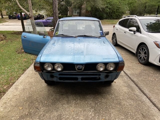

February 4, 20206 yr Going to use POR 15 (degreaser, metal etching, POR 15) then prime and paint. Any other tips? Edited March 23, 20206 yr by TXJayhawk
February 6, 20206 yr Was the strip of foam still on the fender ? Subaru used a sealant foam as a squeak reducer and that over time caused countless fenders to develop that same rust. Good luck with it. Not much to worry about on yours.
February 8, 20206 yr YES...get that foam out of there! Clean, sand and treat. Then primer and paint/multiple coats. Use butyl tape on that seam to seal those new fenders I'm going to sell you!!
February 8, 20206 yr Also looks like you will need to cut some damage out and replace some strips of metal.

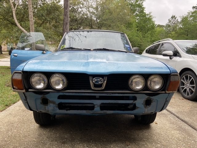

March 12, 20206 yr I’m just curious if you’re going to keep it nice n stock - original , or if at this time you’d have considered a swap to the quad light front ? At this point move forward , I’m sure. It’s just such an opportunity right now that knuckleheads like me feel they have to ask.
March 23, 20206 yr Author It is a GL the new old stock lights I got from Moosens are on the passenger side
