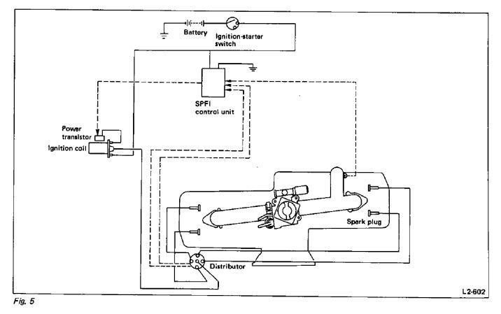

May 2, 20205 yr 58 minutes ago, Jacob 2002 said: when i leave the switch on the coil gets hot Not normal. Electronic ignition uses pulses from the distributer or SPFI Module to fire the coil. If the engine is not turning, no pulses, no current through the coil, no heat. There should be battery voltage on the + and - of the coil. The coil bracket should have a power transistor (ignitor) mounted on it? If so, it is probably shorted. You can unplug it and test it with an OHM Meter. Put the meter on the diode symbol if it has one, otherwise use the lowest OHM setting. The transistor has three terminals one is ground. Put the black probe on ground. You might see 75 on one pin, If you find a very low reading on the other terminal, it is toast. If you get no short on the transistor, the only other thing that could turn the transistor on would be a voltage leak that should not be there from the SPFI module. The diagram is for an 89. The transistor works like a switch. An input pulse turns it on and connects the coil negative to ground and when the pulse turns off, the coil will produce a spark.
