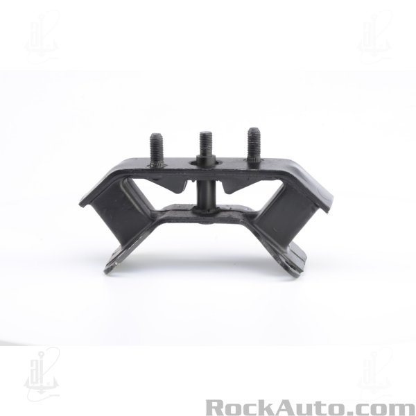

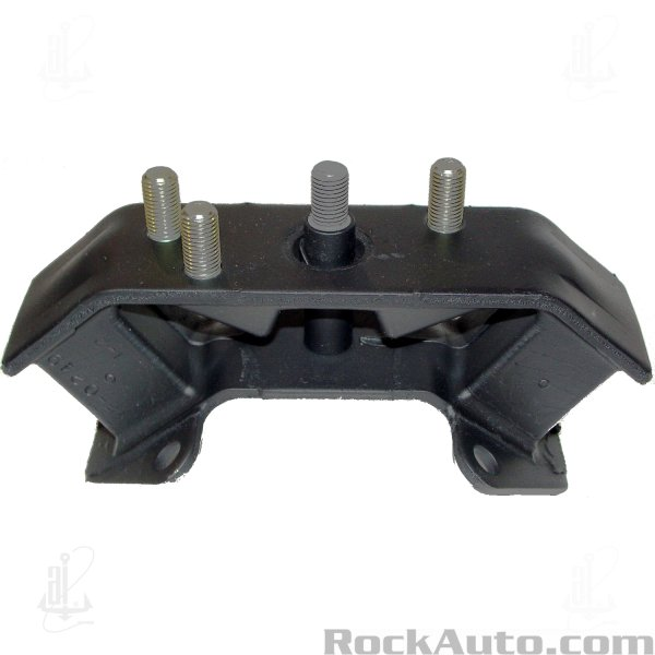

1197sts Posted January 15, 2021 Share Posted January 15, 2021 I need to change the trans mount on a 2000 Outback, Auto trans. I see that there are two types available, it originally came with a 4 stud design, it appears there are 3 stud designs available as well. Anyone with experience on these, does it make a difference? Quote Link to comment Share on other sites More sharing options...

heartless Posted January 16, 2021 Share Posted January 16, 2021 (edited) looking on Rock Auto, there are indeed 2 different mounts listed for auto trans (manual is in a completely different section and has 2 studs).. one has 3 studs, the other 4 studs, just as he described.. if it were me, i would be checking to see what the car has currently, and go with whichever that is. Edited January 16, 2021 by heartless Quote Link to comment Share on other sites More sharing options...

1197sts Posted January 16, 2021 Author Share Posted January 16, 2021 Thanks for the input, I have checked out a 2000 and a 2001 Outback and they both originally had the 4 stud style. I have a commercial parts source and it seems to indicate 3 stud style supersedes the 4 stud style, the question is does it fit the original crossmember and I am hoping it does. I was hoping someone had encountered this before. Quote Link to comment Share on other sites More sharing options...
