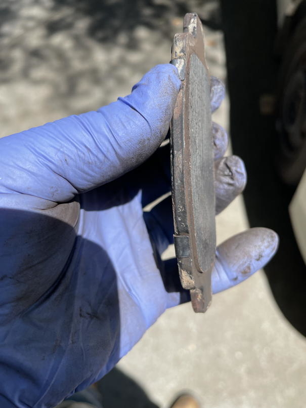

That inner pad is even low enough I wonder if it could be noisy depending on quality and what the other side of the pad looks like we can’t see - maybe it’s warn even more on the side opppsote the photo?
That’s not uncommon for the inner brake pad to wear more than the outer, but that is an excessive difference in thickness. I’d see if the pins are hanging, pin bushing condition, and pad movement in clips.

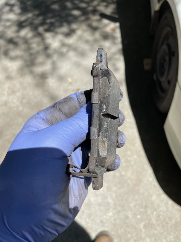

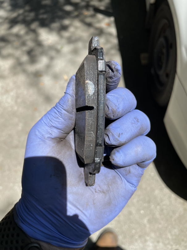

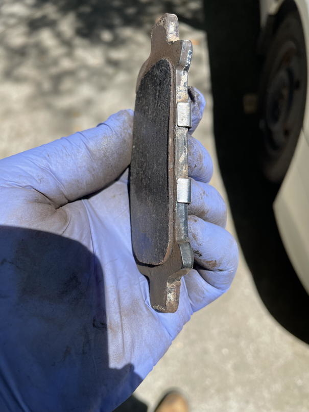

@idosubaru, so I think I'm leaning more towards brakes.  I jacked the other side up and rotated the wheels (actually, my daughter provided the labor) and I listened.  There was absolutely no noise (I did not use a stethoscope, though) on the driver-side.  The only noise was a periodic sound that seemed to coincide with a dragging on the passenger-side now.  Not a squealing (I guess I meant that more than squeaking in my initial post) but just a low, light "scrape" from about 3 o'clock to 8 o'clock on every rotation (looks like I'll be pulling that apart next!).

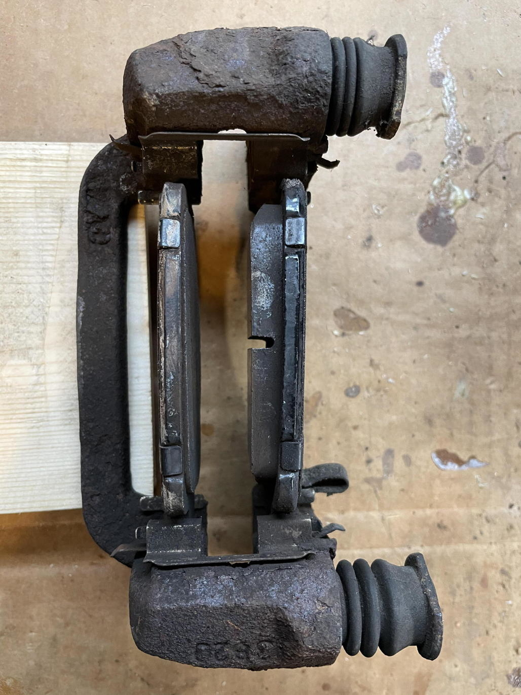

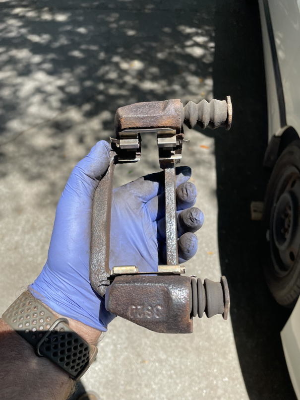

I included some images of the brake shoes off of the driver-side.  The first two are the top and bottom of the inside pad, the one that had the least wear.  Then the next two are of the top and bottom of the outside pad, the one with the most wear.  Lastly, I have the mounting bracket.  The bushing on the top moves in and out freely but the one on the bottom will not move at all.  What impact does that have?
Are you saying the pin isn’t moving? If the pin isn’t moving in and out then it’s seized and very likely your issue.
Twist turn pound to get the pin to move - but sometimes they aren’t going to come out without a torch.  Get a used good one or buy a new caliper and use just the bracket.  Yes that’s crazy but an option.  I don’t trust aftermarket calipers in the rust belt.
Some wheel bearings aren’t diagnosable on the vehicle. They will literally evade all methods - but then when removed you can feel the lumps or otherwise tell.  I don’t know what voodoo allows them to do that but a lack of easily found symptoms is no sure sign it is not the bearings.  But you’ve already seemed to find brake pin failure so it sounds like that’s the starting point.
Yes, I guess I should have said the pin going through the bushing will not move.  So, how aggressive should I be?  Should I put the mounting bracket in the vice and tap on the pin with a hammer?  And, if you're talking about a torch, I'm assuming I'm cutting the bushing off first?  And is the pin and bushing something that is replaceable?  Sorry, for the newbie questions; my Dad and I did a lot on cars but this was not one of them, and he's not around to ask anymore.
Sorry about your dad. Spray some penetrant into that sliding bushing until it works free. Then re-grease it.
Maybe take a few minutes to review some YouTube videos but of course we’ll help from here too. You want those calipers to slide freely. And the pads to slide freely too.
Given the vehicle’s age and where you’re at right now I suggest getting new bearings , the ones set into the housing already , and of course fresh brakes.
Thrifty guys like me will save the pads you have that don’t look so bad. As long as the wear isn’t drastically angled (pad surface beveled) you can keep those handy just in case. And you can square them up quickly and safely if they’re a little off.
You can work that bushing free in many ways but I’m sure putting it in a vice is a very good idea. No heat needed yet. And of course be considerate to the rubber boots or be prepared to replace them.
If it's stuck really bad you might just want to buy a used or new caliper bracket - brackets used to not be available but it seems like they're becoming more widely available. I like used if I can find it because the original factory materials are probably higher quality, more rust resistant and I've seen a couple anecdotal (statistically meaningless) examples to suggest that's the case. Either way - this looks like a really good deal if they're stuck and you don't have a torch.  This is not for your vehicle, just an example - you'll have to look.  I would order locally and take yours with you to make sure you get the right bracket - it's very easy to get the wrong bracket particularly on front 99-02 subaru's.  Rear should be easier but best to check...anyway, for illustration purposes only:
https://www.autozone.com/brakes-and-traction-control/brake-caliper-bracket-front/duralast-brake-caliper-bracket-14-1002/710461_0_0?cmpid=PLA:US:EN:AD:NL:1000000:HRD:71700000043798721&gclid=Cj0KCQjwna2FBhDPARIsACAEc_UsPXj_fc2_TsVcRpB2c45Zokhd_ASMi1-LZIe5cwl8t22tyVh_eoAaArIYEALw_wcB

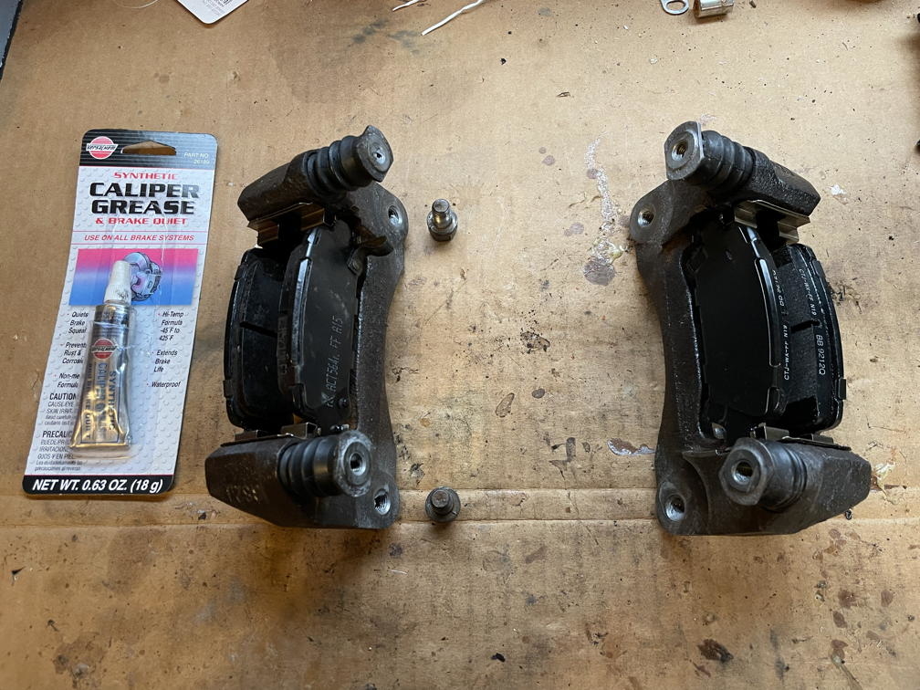

@idosubaru and @moosens,
Thanks for the quick replies and sorry for the long delay in replying myselt.  It was a busy week of field work (I attached a couple of images) so the prep and the actual work made for some really long days.  Not a lot was able to be accomplished car-wise during the week.

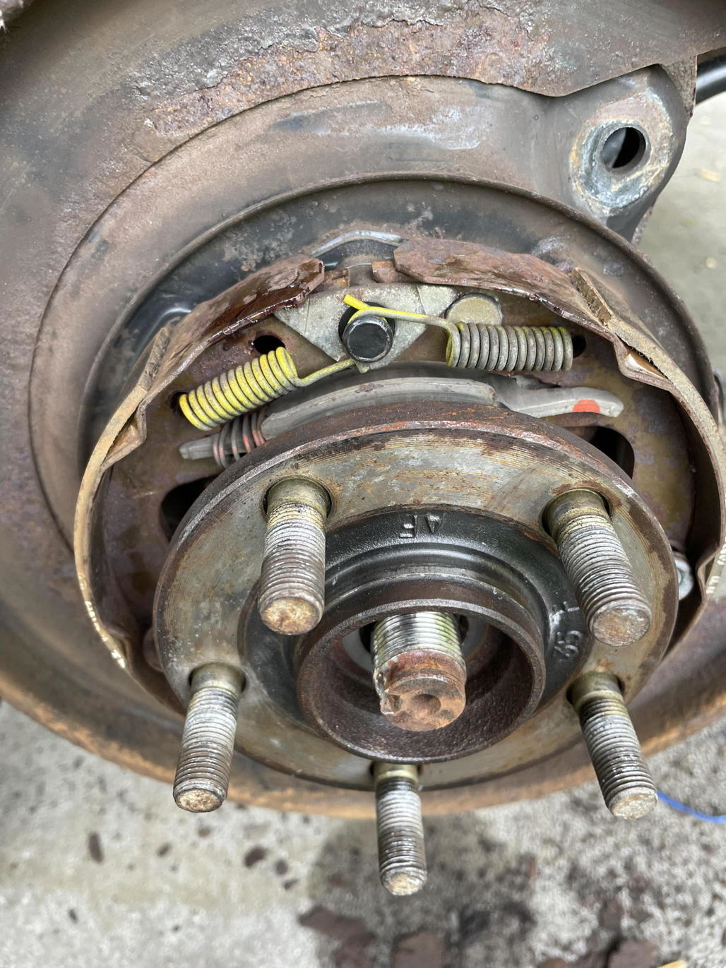

I did get a chance to work on it over the last couple of days though (third attached image).  Given the condition of the driver side, I decided to do the passenger side, as well.  I was able to get all of the pins to come out of the mounting brackets on both without too much difficulty and without damaging anything in the process.  Even the rubber boots seemed to be in good condition once they were cleaned up a bit.  And, after wire brushing, the mounting brackets looked pretty respectable.  I bought new pads and some synthetic brake grease and got it all put back together earlier this evening.  I wasn't able to do a long drive to heat things up and check the hubs but the squealing is definitely gone.  So, things seem promising.
@moosens, I didn't do the bearings because there just seemed to be conflicting information about them.  I found an electronic service manual for the car that I'd forgot I had and, from the bearing section, it still appeared like they needed to be pressed in.

Hey success!  Good job knocking that out.  I thought it was brake pads but was hesitant without being able to see/hear myself. Nice refinish and paint

Took the car for a long trip today, checked the hubs and both were what I would consider a "normal" temperature, so I'm optimistic.  And, although it's probably just my imagination, it just feels like it drives more effortlessly.  I'll be interested to see what the gas mileage looks like.
