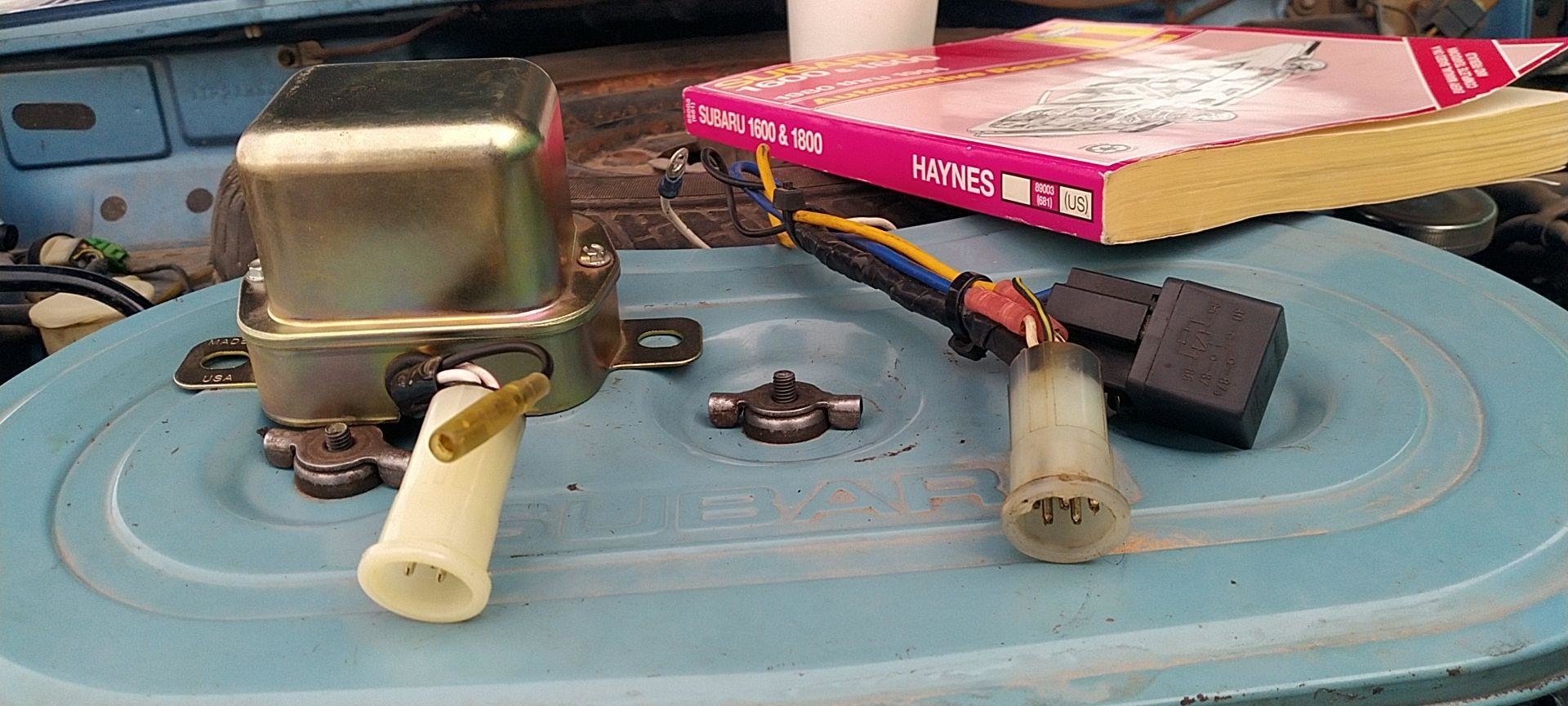

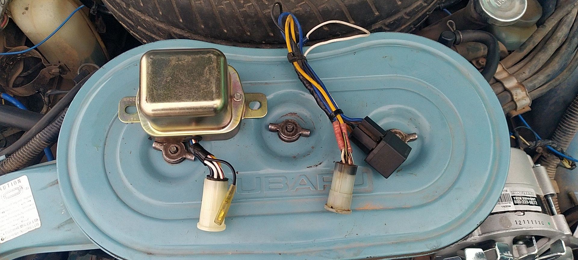

January 14, 20224 yr Author Hey y'all, so I got the new voltage regulator and installed it! I have a question about the loose black wire with the female bullet connector and it's purpose. I don't know what it connects to and what it's used for. Also, because I installed the proper part into the car, the fuel pump isn't getting power, any ideas? The two pictures below are of the voltage regulator (left) and the hack job of previous owners (right). Any help would be appreciated! I tried looking at the schematic and it's isn't very clear
