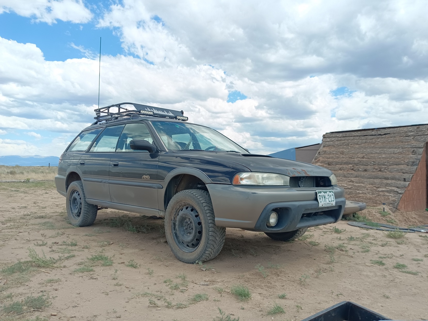

1997 Legacy Outback Limited  EJ25  5-spd  4-wheel discs   4.11:1 finals   limited slips
'04 Forester strut assemblies    1-1/2' lift    215/65-16's
swapped a freshened-up EJ25 with 90k last summer @ ~260k mi

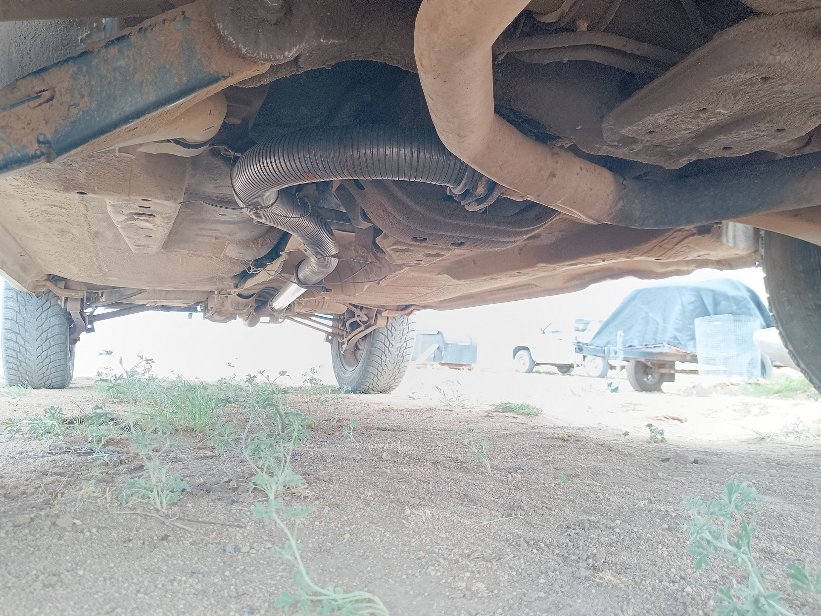

capped and plugged everything but fuel pressure, brake booster, and PCV
Y-pipe header with straight 2" flex all the way back to a single muffler. One O2 sensor.
removed A/C and jumped sensors so 2nd fan runs when button is on (Assisted Cooling)
Dual alternators and dual batteries, isolated systems. Starboard battery just starts the engine. The port battery is deep cycle, and runs everything in the car, as well as connecting to the solar camper to double the power bank.
Overhead off-road lights wired to the former seat heater switches on the center console, roof basket, full-size spare, CB/WX radio system, bluetooth 6-speaker stereo, 10" sub behind the seat, all LED lighting, classII trailer hitch, etc...

              CV axles, driveshaft/center bearing, brake pads/parking shoes, tires, carbon clutch/flywheel set, control arms and bushings, balljoints and tie rods, strut assemblies, ignition coil/wire/plugs, batteries and all cables, all drivetrain fluids, radiator/pump/thermo, timing system/pulleys, F/R main seals, cam seals, turbo MLS head gaskets, pan gasket/pump seals, all cover gaskets, motor/trans mounts, fuel pump unit, and all belts/hoses/filters/fuses....

Dual alternators doubles my amperage output when i parallel them to charge the camper in the event of no sun for days. They are isolated batteries, but share the same ground so my charge light on the dash still works for both.
Yes, they are heavy rubber straps. No, they don't move around. I've had this girl on two wheels, near vertical, and almost flipped her over, even in the air off all fours, a handful of times. Nothing moves. I've taken Lucy where others won't take their fancy Heeps, lol.
