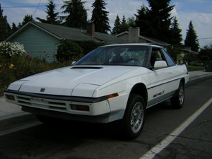

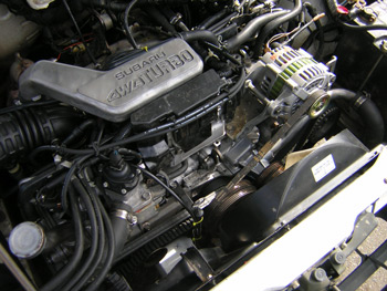

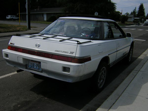

for a while now, my XT has been without its engine.. but its all back together, and I have some other things that I have done to it, besides the engine reseal :brow:
-engine reseal and complete cleaning-
-removed timing belt covers-
-removed PS pump, lines and bracket-
-swapped PS rack with a manual rack from a carbed sedan-
-removed AC pump, cooler, bracket, and lines-
-installed new front brake pads (OEM) and flushed brake fluid, turned rotors-
-installed rear height adjustable struts, max height adjust- (brings up the rear of car to match front)
-going to install new rear diff... mine is toast!-
-installed newish-used toyo winter traction tires :brow: for ultimate rallyX traction-
more stuff to come!
