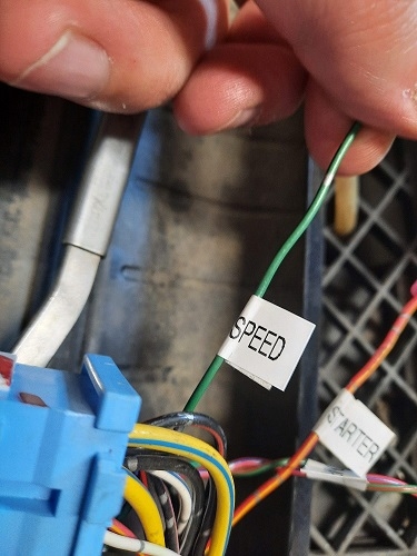

1980ea71Brat Posted June 27, 2022 Share Posted June 27, 2022 (edited) Hi all, I am hoping to wrap up a major step of my EJ22 swap this weekend and just had a couple questions that I was hoping someone could answer. I found some answers from the search but not exact for my situation. The donor car is a 1996 Subaru Legacy Outback 2.2L Harness was wrapped and prepared by SJR Receiving car is a 1987 Subaru RX I have already got the car to run and drive, I am just in the process of getting the gauge sorted and all the wiring routed in their final positions. 1) My speedometer is mechanical, Do I need this wire labeled 'Speed' and which 1987' wire am I looking to tap? 2) I have two wires labeled 'Rad Fan', are each of these a ground reference for the relay? As in, can I wire each to trigger two separate relays for two fans? 3) I have read on here that the Neutral wire is irrelevant for manual transmission cars, just wanted to confirm I leave this one alone. Any help is greatly appreciated. I have a 4.5 day weekend coming up and I am hoping to make some big progress on the project. Edited June 27, 2022 by 1980ea71Brat Quote Link to comment Share on other sites More sharing options...
el_freddo Posted June 27, 2022 Share Posted June 27, 2022 1) this is the vehicle speed sensor. You can leave it disconnected. This wire connects to a Reid switch in the back of the instrument cluster. I’ve heard of a GPS unit being used too. 2) These are for the rad fan relay. I only remember one wire for my Gen1 loom, yours might have a two speed fan setup that’s a little more complicated. But you might be able to run a fan off each relay with the ECU triggering them as needed. Hopefully someone else will know for certain what’s what here. Mine is an ‘88 series 2 and had the Reid switch behind the cluster in a carb model, if yours is a series 1 you might not have this, best to pull the cluster and have a look. 3) Neutral wire I believe you can leave it disconnected. I recall leaving my one disconnected and don’t have any issues. All the best with it! Ensure you finish off all the things you want finished before you start driving, otherwise they’ll always be lingering! Your very close now as you know Cheers Bennie 1 Quote Link to comment Share on other sites More sharing options...
1980ea71Brat Posted June 28, 2022 Author Share Posted June 28, 2022 (edited) Thanks Bennie, its a slow and arduous process. If I can leave the 'speed' wire unplugged, any idea what it does when it has reference to vehicle speed? I didn't get a check engine light last time I ran the engine (besides the engine rad fan being unplugged) Edited June 28, 2022 by 1980ea71Brat Quote Link to comment Share on other sites More sharing options...
el_freddo Posted June 28, 2022 Share Posted June 28, 2022 Dunno what it does exactly. I’ve heard it improves fuel economy but can’t verify that (cuts injectors when coasting down hills etc), and that it helps when rolling to a stop to avoid stalling but again can’t verify it either. GD might have some insight if he takes his “get a link management system” hat off for several minutes Cheers Bennie Quote Link to comment Share on other sites More sharing options...

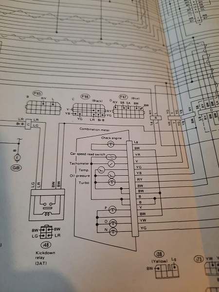

1980ea71Brat Posted June 28, 2022 Author Share Posted June 28, 2022 I thought I had this mostly figured out. But I am hoping to get some more clarity. Here is what I am looking at: Quote Link to comment Share on other sites More sharing options...

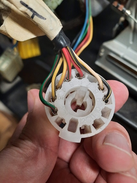

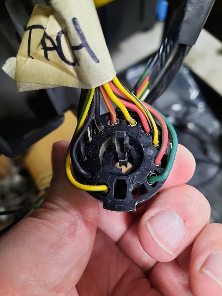

1980ea71Brat Posted June 28, 2022 Author Share Posted June 28, 2022 (edited) So according to the diagram - I am looking for: EJ22 Check Engine Light wire to Blue/Green (Combination Switch?) EJ22 Oil Pressure wire to Yellow/Black (Black Combination Switch #9) EJ22 Coolant Temperature wire to Yellow/Green (Black Combination Switch #1) EJ22 Tachometer Signal wire to Solid Yellow (Black Combination Switch #7) These should all be connected 'Going into' the combination switch to feed the corresponding signals to the Gauge Cluster. The last signal is the VSS signal (if I wanted it, sounds like not needed) which should be: Yellow/Red (White Combination Switch #4) to the 'Speed' Signal wire EJ22. This should be the only connection made 'leaving' the gauge cluster correct? *Edit* I guess this would actually be hooked up the same as all the others, the only difference is the signal is coming from the Yellow/Red wire instead of the other way around. All 5 connections should be made with a wire coming from the EJ22 into the combination switch. Does all that make sense? This only leaves me with my check engine light... the only Blue connector I see is on the 'Clear' Combination switch. Thoughts? Edited June 29, 2022 by 1980ea71Brat Quote Link to comment Share on other sites More sharing options...
1980ea71Brat Posted June 28, 2022 Author Share Posted June 28, 2022 (edited) The other wire that is close for the check engine light is the Green/Blue wire @ Black Combination Switch #11. Possibly just a typo from the manufacturer? That Blue wire off the clear combination switch is like blue/yellow or blue/white Edited June 28, 2022 by 1980ea71Brat Quote Link to comment Share on other sites More sharing options...
el_freddo Posted June 29, 2022 Share Posted June 29, 2022 For the temp and oil wires just use the engine wiring loom from the EA82 and plug the wires for the oil and temp sensors onto the EJ units. Job done there. Check engine light - changes to a Red/Yellow wire if I’m reading the wiring diagram correctly. There’s a Red/yellow wire in pin 6 of the black connector. I can’t see where the CEL wire goes in the diagram as that black plug should be referenced in there and point to pin 6 being the required pin. Hopefully you’ll be able to see this with the wiring diagrams in front of you as it’s hard to put them together online! Tacho wire certainly seems to be the yellow wire in pin 7 on the black plug. The VSS wire could be pin 4 on the white plug. Again you’d need to trace the wiring diagram to see if these line up to what we think we're looking at. If not we need to go back to the drawing board Cheers Bennie 1 Quote Link to comment Share on other sites More sharing options...
