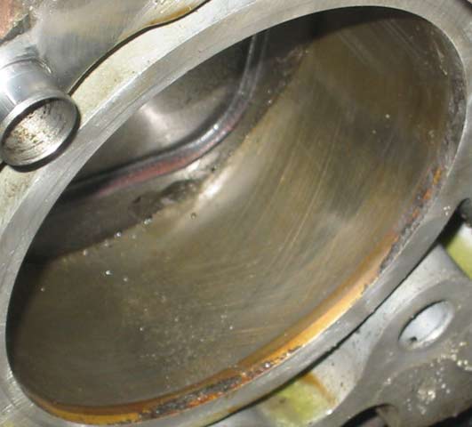

I just saw a Phase 1, with 140K, torn apart for a HG, and it still had the original honing marks on the cylinder bores. The Phase 1 2.5 did have problems with the stock seperator plate leaking. The revised part is an aluminum plate as opposed to the stock plastic plate. Which cures the problem, though a little late.....:rolleyes:
Heck, that engine with 205k on it still had the honing marks visible.
You mean, like this?

Yep. That's done to create a non directional finish to the cylinder bore.
