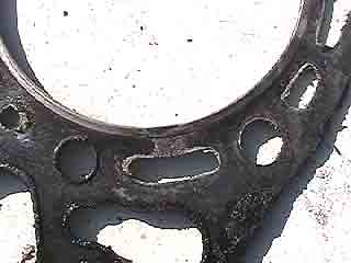

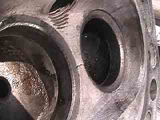

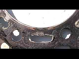

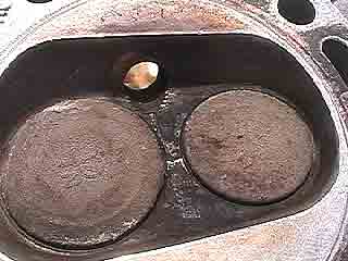

I wouldn't even be asking this except for but two reasons. the first is obviously ignorance. The second is until the head gasket blew (and it was just a slight breach) the '86, 1800 Subaru GL was running pretty darn good. Plugs were clean, no skipping, no smoking or steam. Even when the gasket did blow the coolant pressure check didn't show any signs of leakage although she did start to steam intermitantly.
After finally getting the engine out (thanks again for that help) and breaking down the heads; on clean-up I could see the cracks running between the exhaust and inlet valves. By the looks of both heads I figure this is something common. That pretty much lets getting one through a salvage yard out. Is this somethhing that could be lived with given the running order of the engine prior to dismantaling? Or is the only alternative replacement?

those heads are still good, cracks between the valves are a normal feature oin ea82. even if they go down to the valve guides they are ok.
what would be bad if the cracks are gapped open, allowing a valve seat to drop. what you can do for preventative measure is close the cracks with a punch or drift, and stake the valve seats in
chances are that if you go junking for another set of heads they too will have the same cracks
beware of cracks in the exaust port on the bottom of the head, as this is where the water passages are in the head, and cracks there will allow coolant loss out the exhaust, but otherwise still run fine, no water in oil

Whewww!!!! You made my day. I'll have to wait until tomorrow to make my daughter's. My biggest concern was the possibility of loosing a valve seat and the piston chewing it up and digesting it into the bowels of the crankcase. NASTY!!! I am one of those who has to live by "Murphy's Laws." When staking the seat should I take the aluminum over the seat?
Good or bad I'm going to button it back up and hope for the best. It's like I said, it was running fine before the gasket blew. Looking at the pics you can tell this isn't something that occured several miles ago.

I'm amazed at a couple of things from this experience. A cracking problem first off. But a cracking problem that an engine can live with? Its a new one on me. The valve guides feel great so I can't say it has been detrimental so far. They all lapped in today and the head is true so I suppose I'm going to start buttoning her up tomorrow. You can tell by the pics that the gasket didn't drive far. In fact it never redgistered on my pressure guage.
