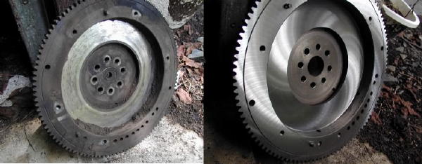

thedoctor Posted July 23, 2005 Share Posted July 23, 2005 How do I get the pilot bearing into the flywheel. I should have had it pressed in at the machine shop I guess, but the old one practically fell out. I just ruined one trying to hammer it in. Now I have just the old one, which I am reluctant to use. Any tricks on how to get it in there? torch? vise? I have to get this thing on the road by Monday. Quote Link to comment Share on other sites More sharing options...

thedoctor Posted July 23, 2005 Author Share Posted July 23, 2005 Thank you. I found the problem. When the machine shop resurfaced my flywheel there was a slight bur around the edge of the center hole. This caught up my pilot bearing and started me down the wrong path. I cleaned that up with an abrasive wheel on a drill press and the new pilot bearing went in with just a few taps. Now I'm having problems with the release bearing. See new possible new post if my search for answers doesn't show up anything. Moral of story: A pretty flywheel can still have a bur in its hole. Quote Link to comment Share on other sites More sharing options...
