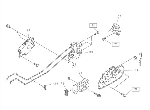

May 2, 200619 yr Hello all you Subie nuts. I have a '97 Legacy Outback Wagon. The right rear door is stuck shut and will not open. It would appear that the lock mechanism has gone haywire and will not unlock. I cannot remove the door panel with the door shut and I cannot seem to snag any release mechanisms when reaching through the space with the window rolled down. Looking at the lock rod it does not move when the lever is moved and I cannot move it with a piece of coat hanger. The lock lever on the door is springy and feels stuck. The inner door release feels like it is also bound, but does move through the full stroke when moved. The outer door handle feels disconnected or loose like they feel when the doors are locked. Any help would be appreciated.
May 2, 200619 yr Hello all you Subie nuts. I have a '97 Legacy Outback Wagon. The right rear door is stuck shut and will not open. It would appear that the lock mechanism has gone haywire and will not unlock. I cannot remove the door panel with the door shut and I cannot seem to snag any release mechanisms when reaching through the space with the window rolled down. Looking at the lock rod it does not move when the lever is moved and I cannot move it with a piece of coat hanger. The lock lever on the door is springy and feels stuck. The inner door release feels like it is also bound, but does move through the full stroke when moved. The outer door handle feels disconnected or loose like they feel when the doors are locked. Any help would be appreciated. Even if the childproof lock mechanism on the side of the door (near the latch) was mistakenly flipped "on", the door should still open from the outside. The inside door trim panel will have to be removed to access the linkage and see what's broken or disconnected. It will be necessary to remove the rear seat bottom cushion (it's secured to the floor with two 10mm or 12mm bolts that are hidden by little carpet "flaps"), then remove the door armrest and lock knob trim pocket from the panel, before trying to pry the panel loose from the door. Any way you look at it, this is going to be a clumsy procedure because the panel is obviously meant to be removed with the door open..... As an alternative, you may want to try to remove the outer belt seal (the black metal and rubber trim strip at the base of the window on the outside of the door) because that will allow you enough room to get a coat hanger into the door and possibly snag the latch linkage to get the door open. Note that the belt seal is easily bent when trying to remove it, but they're still readily available from Subaru

May 18, 200619 yr Author Well, I got the door panel off. It was actually easy. I just popped it loose at the top and pulled it down far enough to reach the rods that work the lock mechanism. Here is what I found. The actuator rod for the exterior handle had fallen off the upper pivot and jammed the power lock mechanism. This meant that the exterior handle was disconnected and the door was permanently locked. I removed the rod and found that the little plastic bushing with the rod retainer had broken, causing the rod to fall off in the first place. I should be able to have it fixed when the $2.00 bushing arrives. At least I can now open it from the inside until I get the part. Thank you all for your I ideas and help!
