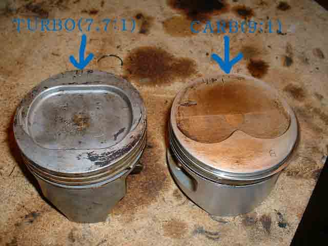

Here is a pic of the two pistons. You should check out the "splitting headache" thread in the retrofit forum. It has some good pics of the pistons( an NA one sawed in half) long thread but the piston pics, and a sketch of my head idea are there starting on the 3rd page or so.

We will have to agree to differ over quench zones but judging by the piston crown pics the turbo ones are better because of the wider "flatwasher" section on top . The "dish" is pretty crude but functional I suppose .
