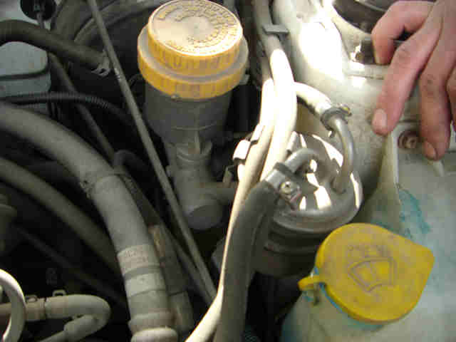

dj3stripes Posted May 1, 2008 Author Share Posted May 1, 2008 thanks for the reply. i took it to oreily's and they let me borrow their tool, very very easy to navigate. lovely P0340 camshaft position sensor circuit malfunction. I've been digging on the forums and it looks like it's gotta be replaced. can't find one here in omaha but being that this problem is intermittent i think it'll be ok to wait for it to get shipped in. is 43bux a fair price from advanced auto, or should i look elsewhere? went ahead and bought a new air filter (easy) and fuel filter (looks easy but first time doing it) just for the heck of it. I figure i'll clean the contacts on that sensor while i'm in there. Also gonna try to wipe off any oil build up and snap a few photos to show everybody Link to comment Share on other sites More sharing options...

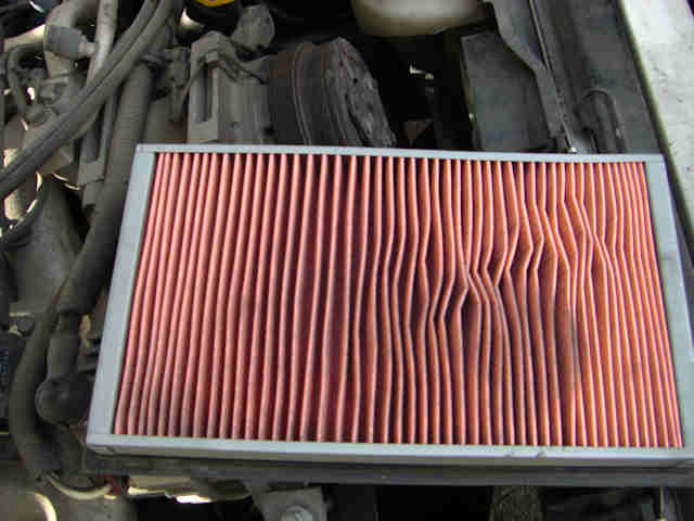

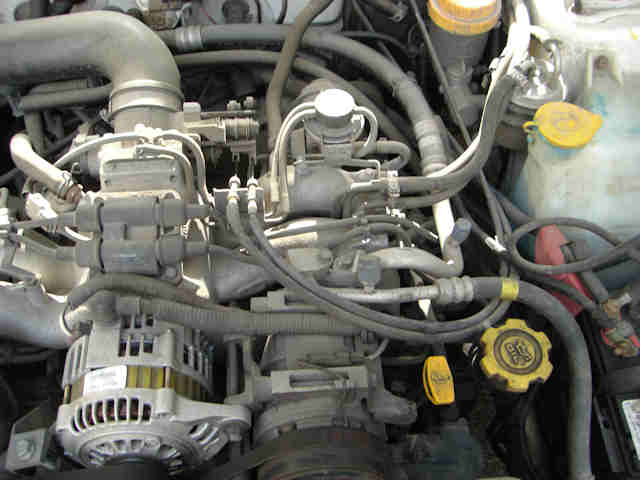

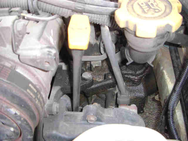

dj3stripes Posted May 2, 2008 Author Share Posted May 2, 2008 well i'm not sure what a sensor is supposed to look like when it goes bad but the contacts on both ends look sparkling clean, the wires had no breaks. I didnt take it off, just unplugged it as i didnt have a replacement to put on. we replaced the fuel filter and air filter. i've attached some pictures showing how oiled up the drivers side of my engine is. we're going to power wash it off another day and check later to see where the mess is coming from Link to comment Share on other sites More sharing options...

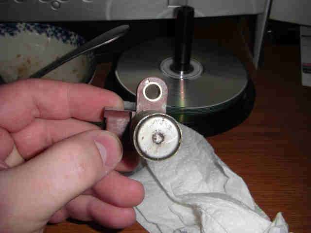

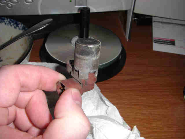

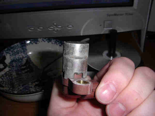

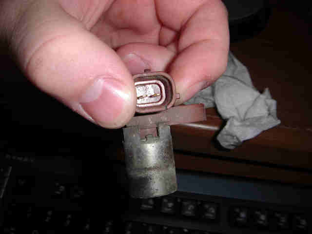

dj3stripes Posted May 2, 2008 Author Share Posted May 2, 2008 ok, last post (i'm pretty sure) but i wanted to show pictures for those who are as timid as i was about working on my own car. EASIEST repair possible............. this lovely device is just where it was described between the timing belt housing and the oil fill. Mine was filthy, i'm not sure if this filth had anything to do with the failure but I managed to wipe away some of the build up around the area as well just for good measure, here are pictures of my bad sensor. I just hope I can now look forward to not randomly stalling/having problems restarting. Thanks for everybody's input. Link to comment Share on other sites More sharing options...
