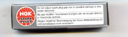

This came up as part of another discussion, but I thought I would post it here. In the old days, I always checked and re-gapped my plugs. They always seemed to need it. In the last several years, I have been using better quality plugs in general, and the NGK Laser Platinums for the Subaru in particular. These plugs come gapped at .044. My Haynes manual says that this plug should be gapped at .039 to .043 for this car (97 OBW 2.5). The box says not to re-gap them because you might damage the center diode. I have checked a bunch of them, and they were all indeed gapped at .044, so at least they are consistent. I have taken to just putting them in as they come out of the box. Given the design of this plug, I don't think the gap widens much, or at all, with use - am I wrong?
So, should I be re-gapping these plugs?
If so, to what gap?
And is there any chance that running them at .044 is causing any of my misfire issues discussed elsewhere?
44 is not causing a misfire. or more correctly if it is - then something else is wrong. i'd gap them to the proper specifications, taking care not to damage anything. owners manual should tell you and if those 39-43 numbers are what it says then use those. you're not going to notice a difference though except that maybe you'll need to replace them 5,000 miles sooner, but who's counting and maxing out their plugs?

Newer plugs, depending upon what they are made of, should nOT be gapped (but you can check them if it makes you feel better). They come from the factory pre-gapped. You trying to gap them may actually brake the plug electrode.

That's what I thought, just running down every possibility on the mis-fire front. Thanks.
