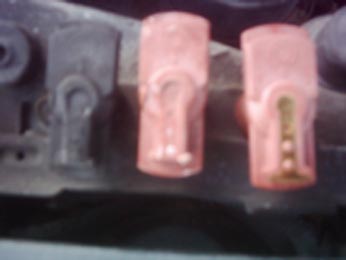

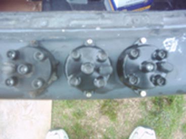

March 27, 200818 yr Author Ok everybody, this is the deal. I've been to Napa for more parts and although the cap looks close to the original there are some minor differences that may or may not affect operation. The rotors all appear to be identical, but when installed, the contact on top of the rotor was ripped off and the cap itself was cracked(see pics). To tell you the truth, I'm getting a little gun-shy about this, I've already ruined two[2] rotors and one[1] cap. I've purchased another set but it looks like the others. Several people have indicated that the cap only goes on one way. For some reason, that does not apply to what I have in my rig. It can go on in the reverse direction, even the old one i took off can be installed to its opposite. Now, one last question: Since this cap can be installed either way and the rotation is counter clockwise; does it make any difference as long as the wires are in the correct firing order (remember, I'm not a mechanic and I've never played one on TV) I've got to get this rig back on the road, my other vehicle is at me mums and she is 76 and lives about thirty miles away. Not an ideal situation. So if anyone has a difinitive answer, I'm all ears ...
March 27, 200818 yr Now, one last question: Since this cap can be installed either way and the rotation is counter clockwise; does it make any difference as long as the wires are in the correct firing order That is correct. As long as the wires are arranged in the propper order it doesnt matter. However, if the cap isnt perfectly seated, it will be off center and when the rotor rotates, it will grab the edge of the cap and destroy the rotor and/or the cap. -Brian
