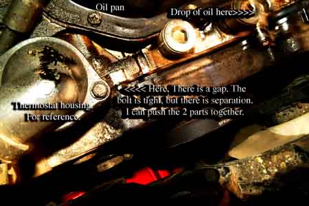

Here's a photo that might help clarify:
http://users.sisna.com/ignatius/subaru/oil_leak.jpg
